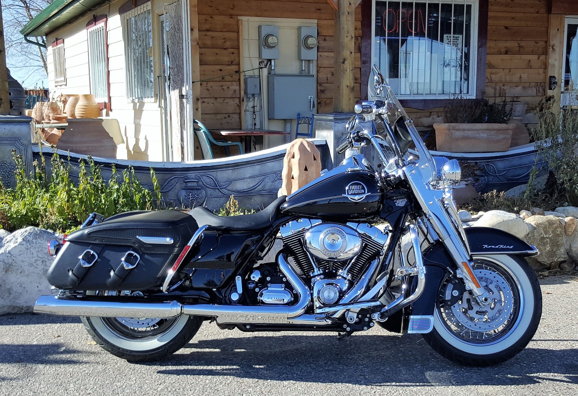

Last spring I put a set of 10" Khromewerks Bobber ( 300210 ) bars on my King until I get around to putting the 14" 1 1/4 " apes on I want ( money pending ) . You can get away with 10" without having to change anything else . The reason I picked the bobber style was because they are designed to put your wrists straight with your forearms ( very close too ) . My hands would go numb and wrists would get sore and since the change all is good . Not trying to sell these , they just helped me a lot with the pain I was having and made my rides a lot more enjoyable .
My friend has a set of used Heritage bars he got off ebay . Went on easily enough and didn't have to change anything . He likes them a lot .
Here's a pic of the Bobber bars I put on last season .

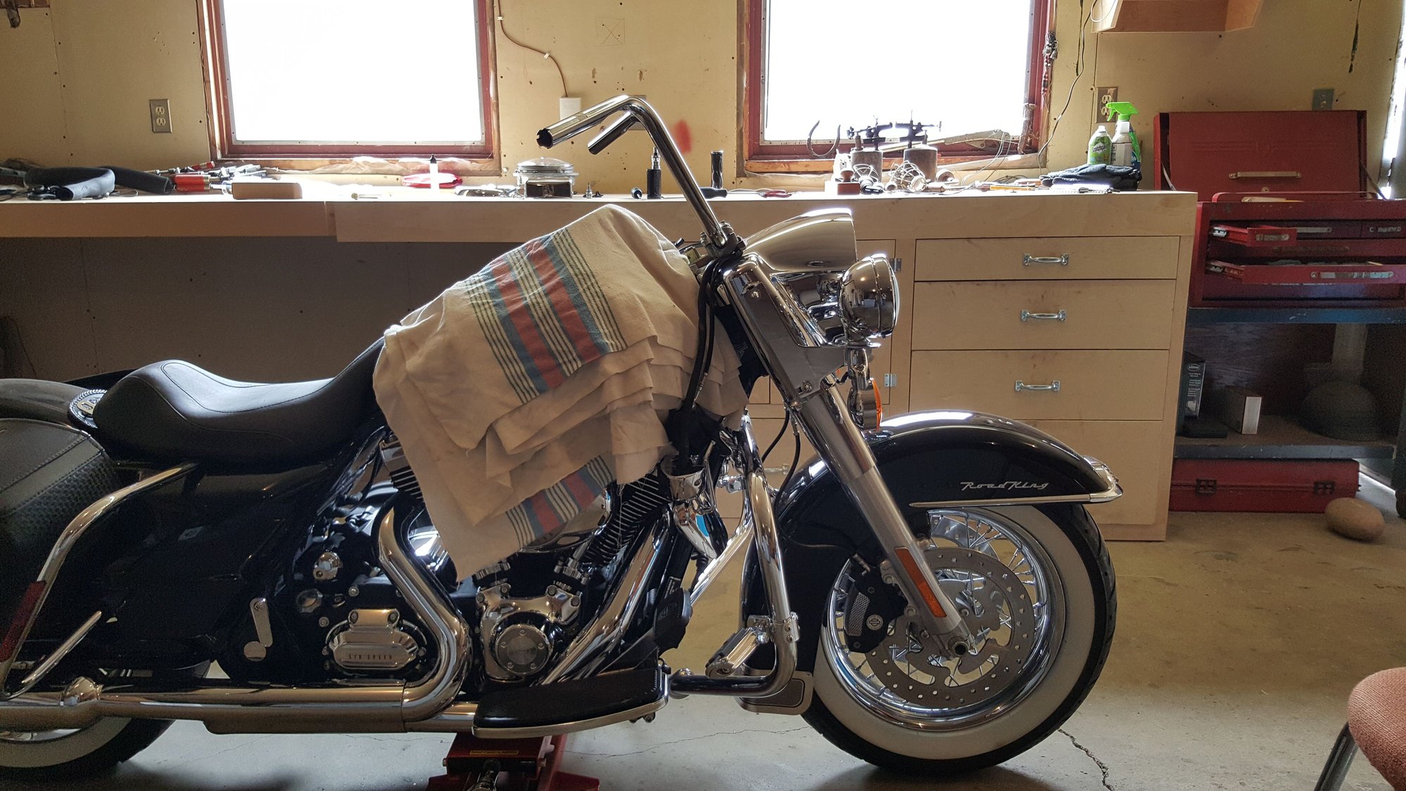

Hi folks, thank you all for the help regarding choice of a good handlebar.
I followed what I have read here and I bought a Chrome Werks 300210. That's almost exactly what I needed. Same height, same width, OEM cables and "Fist front". Why "almost" ? I wish it was a little bit higher, but I didn't want to change the cables :-)
Here are the pictures, before and after :
The good positioning of the handlebar on the Road King is a mess, it took me 40 minutes to change the position. My advice is : Put the handlebar in line with the fork at the beginning, that's a good first position.
