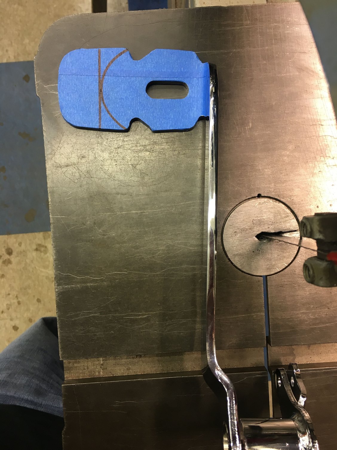

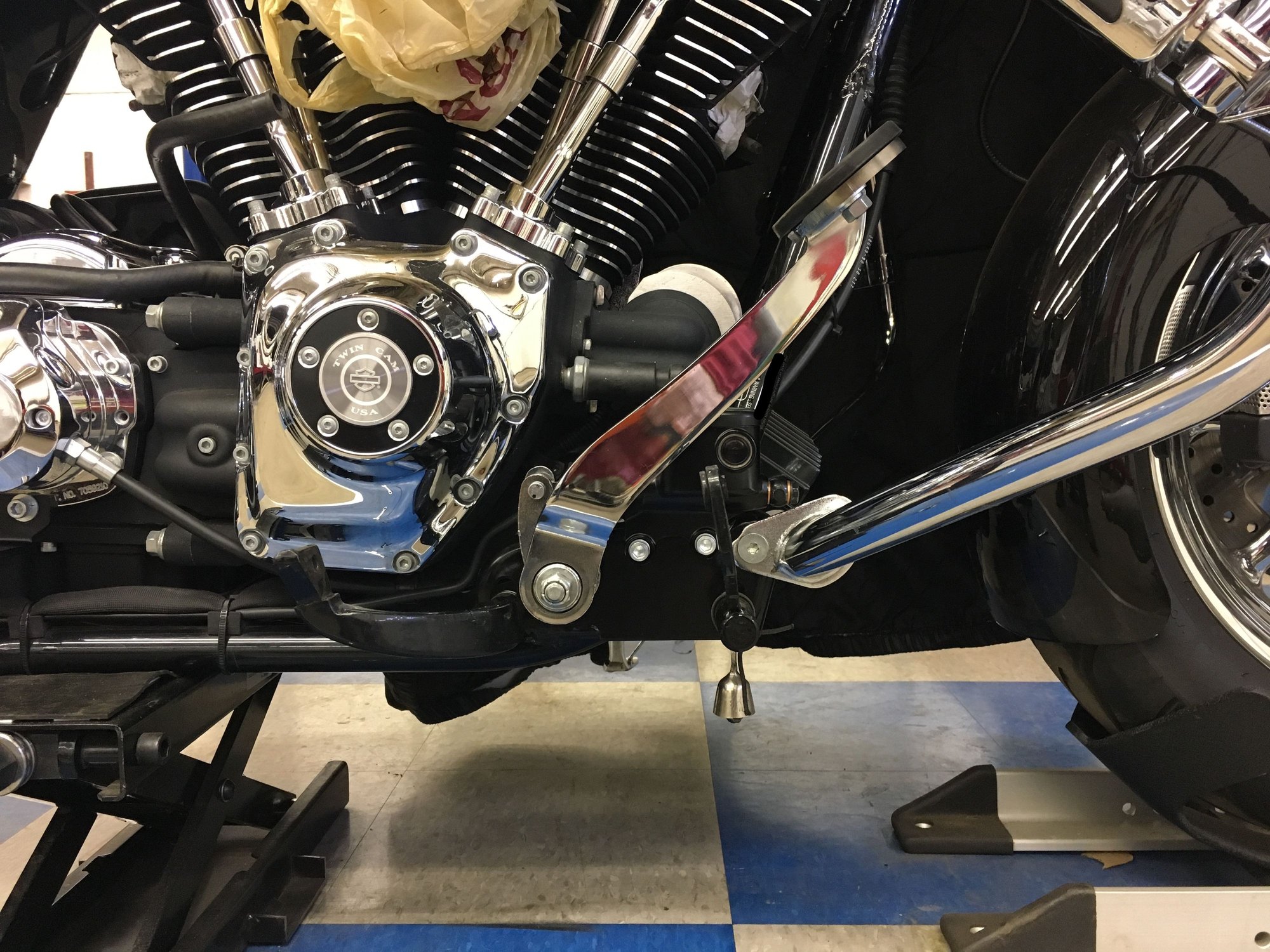

Just take it off and cut it. I have done mine twice, no problems and a lot better than the truck brake pedal deal from the factory. Old style oval pad and a little clear or black paint under the pad on the cut to prevent any rust. Easy.
I also spaced the boards out 1". Putting tape on the pedal, both sides and cutting will not bother the chrome at all. That is a oem 2008 up pedal.

Band saw is the best way. Used the oval pad to get the curve correct. I cut down the the long line first then did the curves. Make sure to cut on the outside edge of the line. Then use a verticle belt sander to finish off the cut and contour. I lay them on the sander table and push lightly into the vertical belt and finish it. You can order the vintage oval brake/clutch pads through ebay, kirk etc. I got the one with two identical pads.
