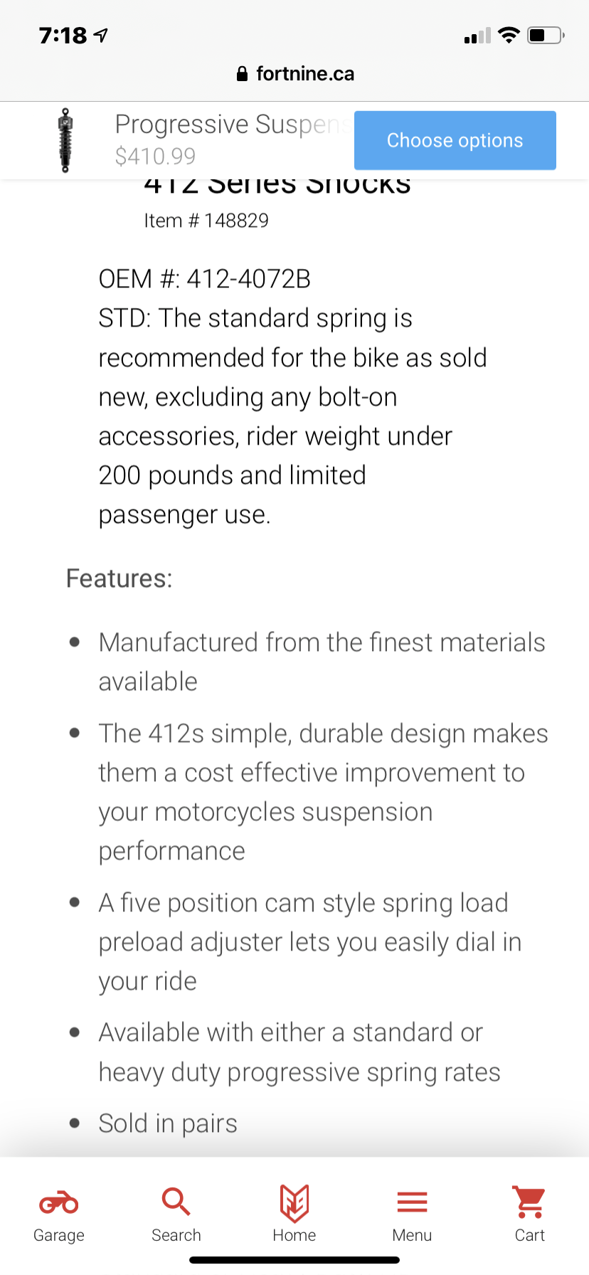

Hi guys.
Im looking at some progressive 412 shocks
for a 2018 Street Glide.
The stock shocks measure 12 inches
center to center and they say LOW on them.
I only weigh about 150 pounds and the shocks that are on are ****, I have played
with the adjustment **** from as
loose as it goes to as high as it goes and they are terrible at any setting, hit a bump
and it almost hurts. The Question is.
Would a pair of 13 inch progressive shocks be beneficial?and would the 13 inch shocks
compress to 12 inches with the weight of the just the bike on them?
I can flat foot the bike with no problem so if
it was slightly higher I could still have both feet on the ground. The 412 shocks you can turn the cam style preload bottom to set them to your preferred ride. I’m in Calgary Alberta Canada so bike season is about here finally about here... Your thoughts, here is a picture of the stock shock and the 412s
Thank
Dale M
