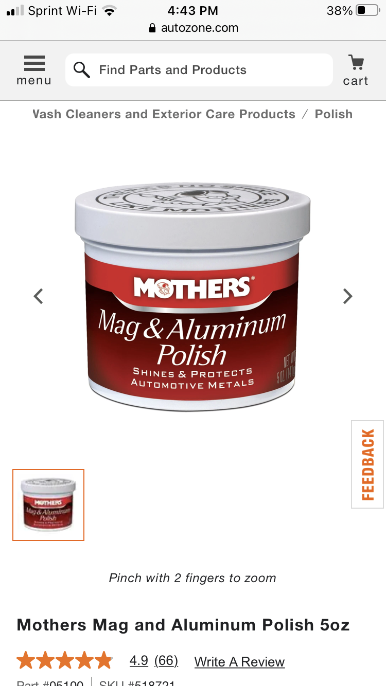

Originally Posted by Ridgeracer
Dealer tried this
How did the Mothers work? Another good one to try is White Diamond metal polish.
