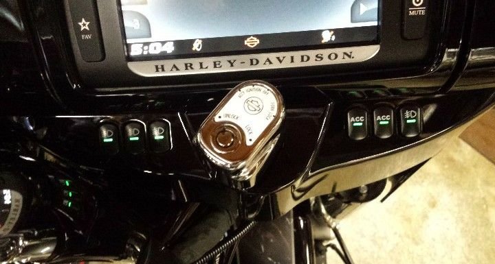

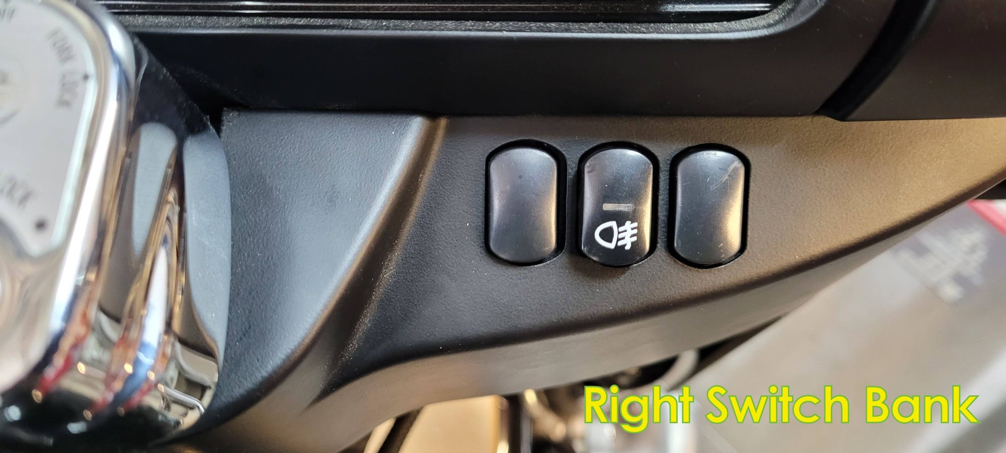

I previously installed a light switch on the left accessory switch bank for my Moto Lights caliper mount lights. Now I'm adding a switch in the right switch bank for my soon-to-be-installed Clearwater Sevina lights. The H-D switches typically have the logo on the top portion of the button. The button I have for lights when installed on the right switch bank is inverted and has the logo on the bottom (see pics). Is there any way to reverse the logo on these buttons so that I have both logos on the top part of the button? Or is there a part number for a light button that is made for use on the right side?

I would say pull the unit out and turn it over so the lamp logo is on top.

Me too. That's the universal symbol for front fog lamps. The wavey line represents fog. The diagonal lines represent the downward angle of the beam.
Flipping the switch (if possible) would put the symbol in the correct orientation.

only goes one way cannot invert it. Maybe can pull out the button and turn it not sure

Post #3 in this thread makes it sound like the switch caps can be pryed off and inverted.

Yeah, I was thinking this was a possibility when looking at the button and hadn't seen that thread. Just wasn't sure how easy it would be to get off w/o breaking something on the button. Good to know it can be done successfully. At least the individual buttons aren't too expensive if I have an oops...
[EDIT]
Ok, just fixed it. I was able to pry off the switch cap and flip it over. The only added step is that the cap has a raised key on the inside of one end that I had to grind down with a dremel tool so that it could slip on in the "upside down" position. Done.
