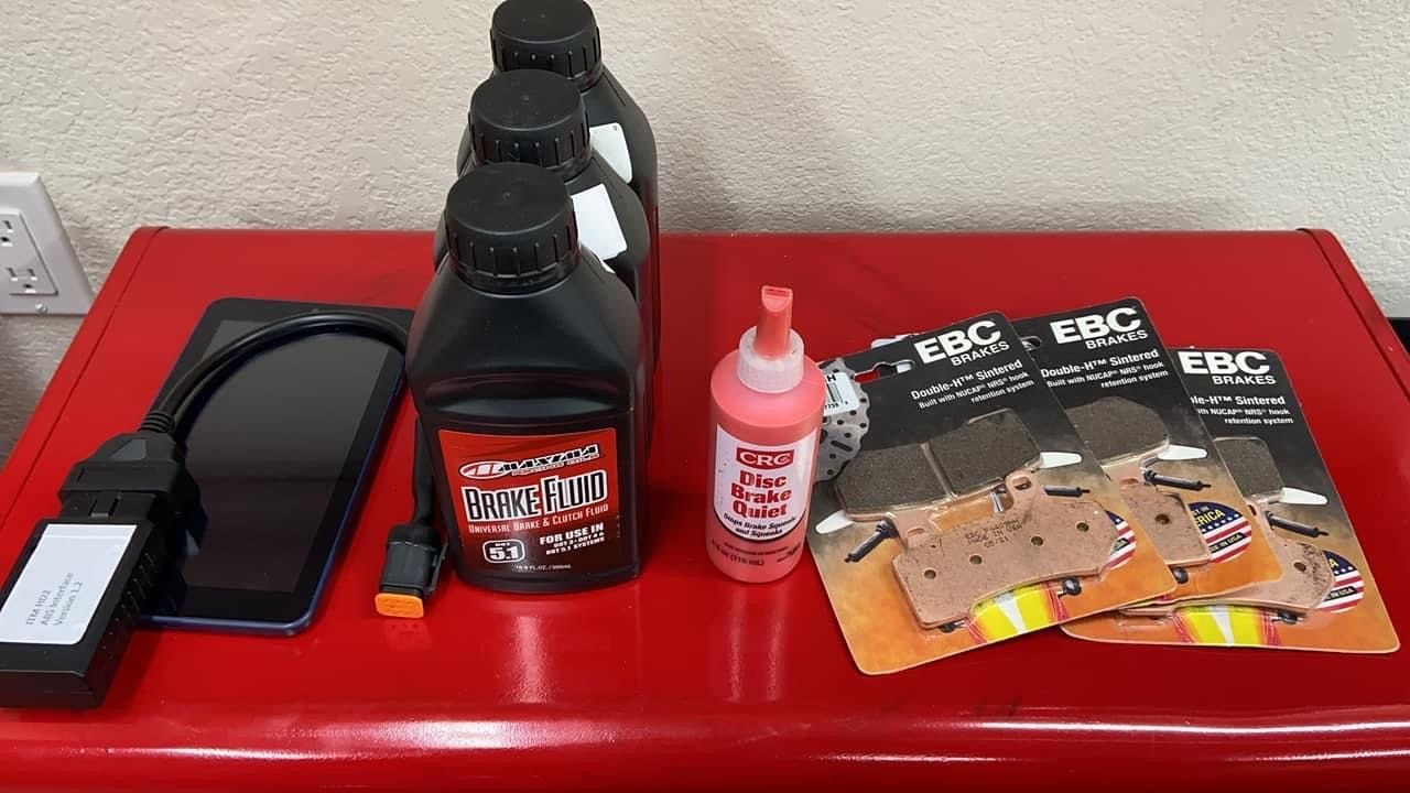

I put EBCs on my front. They work well, but have a scrubbing sound. Its actually kind of cool, because I can tell at what speeds the front “ breaks” engage when I apply just the rears. It was a “DYI” for me, and it was pretty damn easy, especially if you watch some YouTube videos.
