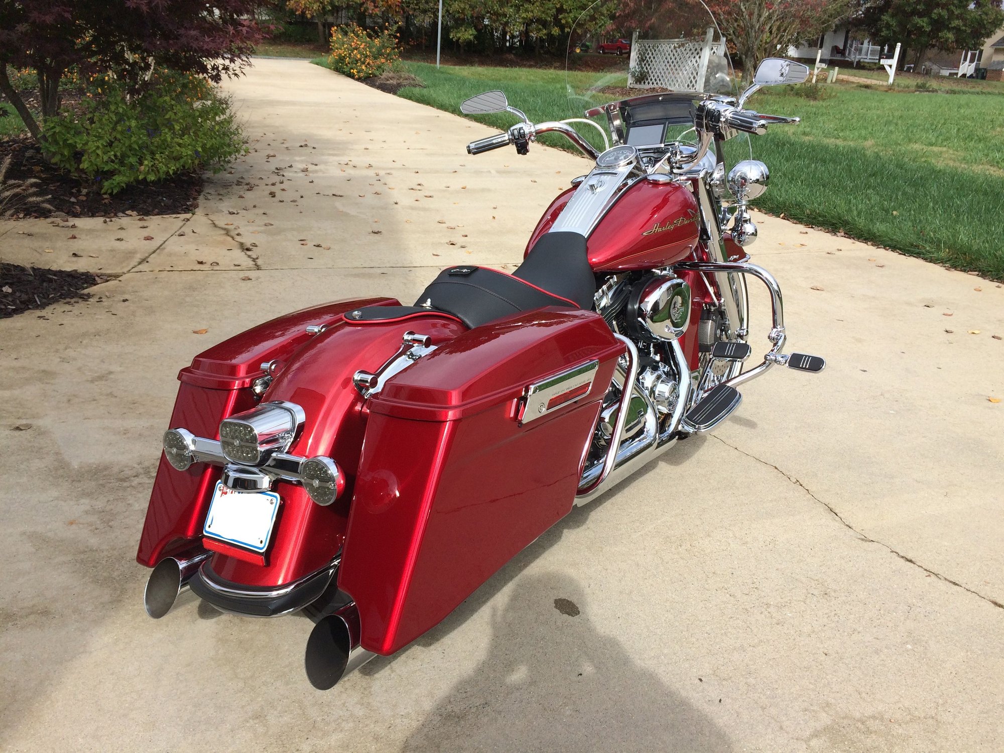

I got those turns and the box style tail light in smoke lens. They worked good for about 5 years on my '13 King and then one-by-one the LEDs started going out. I put the regular lollipops back on and replaced all with Custom Dynamics LED lights. They just plug into the regular bulb sockets. The Custom Dynamic LEDs you'll need a load equalizer, but those H-D lights don't need one.
On the tail light wiring, I just ZIP tied together and place light cavity. I didn't want to push the wires into the fender.
If you don't already have one, get the module that makes the turn signals into run/brake/turn here.
This is what mine looked like

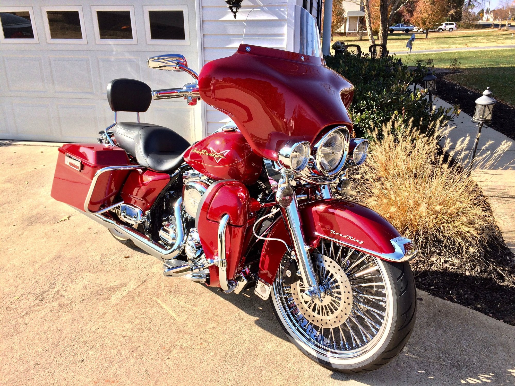

I had the H-D turns all around. They all worked fine. The rear turns and the tail light started burning out one LED at a time. The fronts were good. Here's my winter riding config. Keep your original turns if you decide to go with the "plug-in" LEDs from Custom Dynamics.

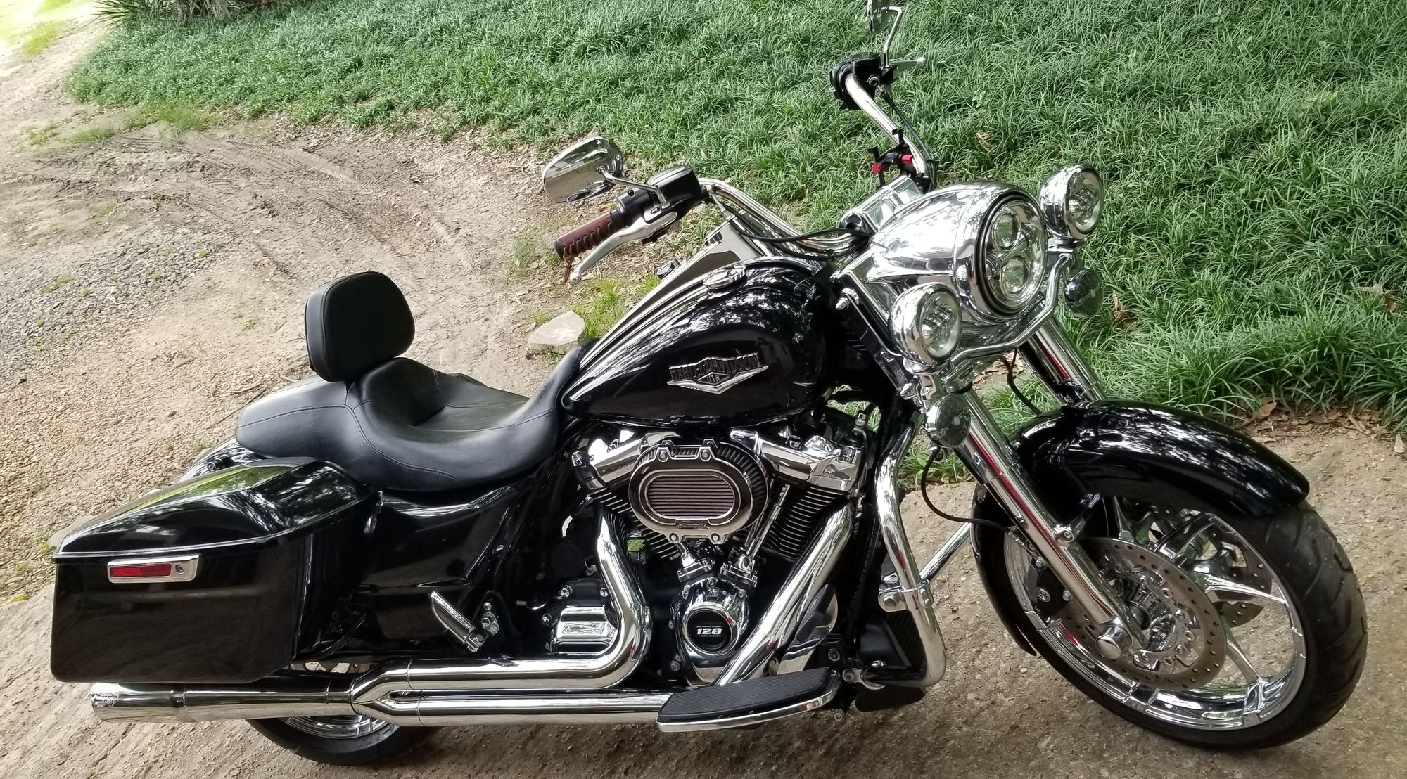

My 2019 Roadking front was an exact plug and play and now for over a year no failures to front or back. There was 1 wire that had to run up thru the spotlight stud and tie in.
Also my rear lights cam with plugs to add after wiring was run. Followed directions and then plugged them up fairly simple. Mine also work as brake/blinkers without adding a module.
Hoping all the issues were fixed over the years.
