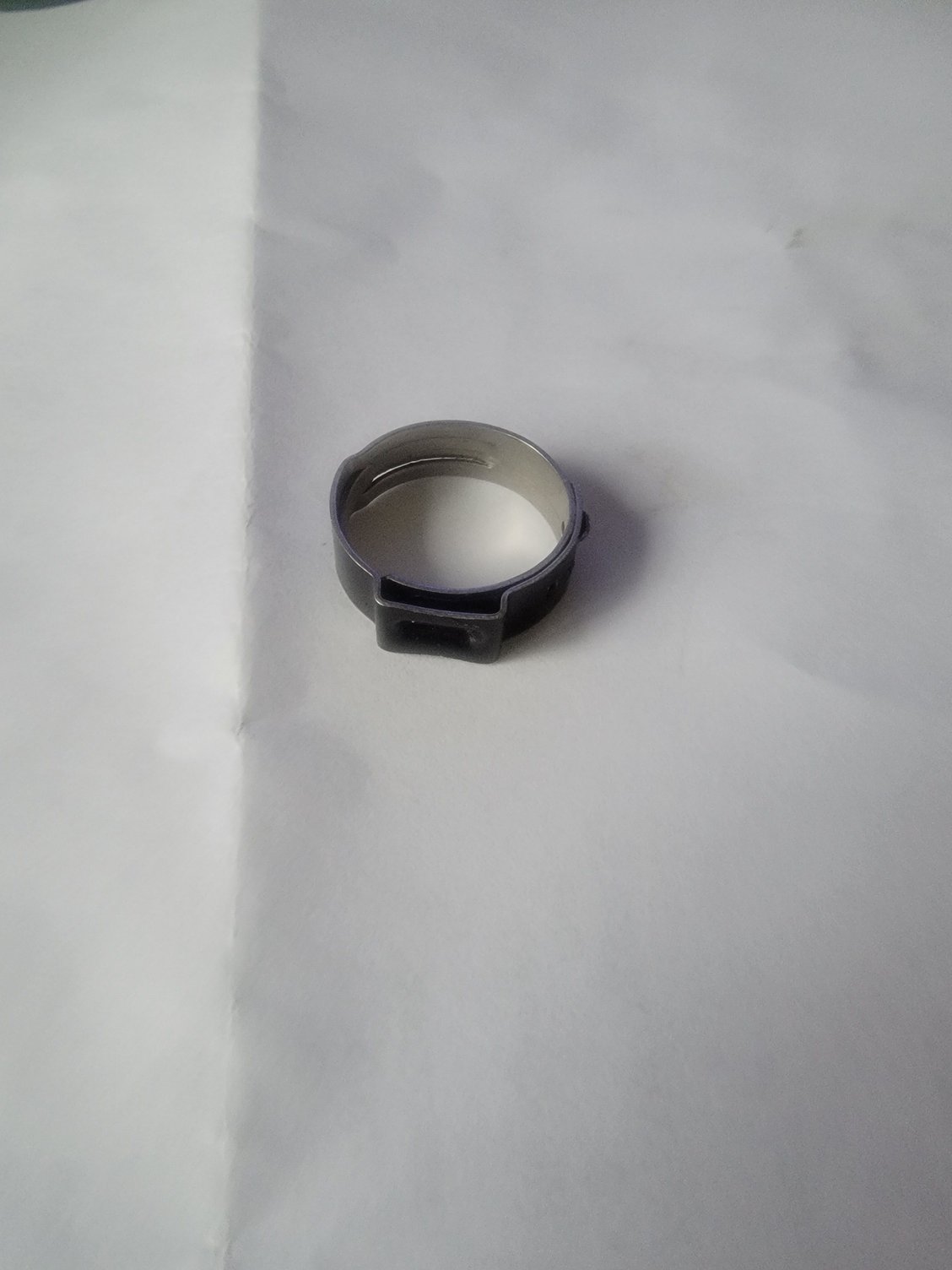

Mongo I ordered HD part number 10249 and they come in black. To be safe check with your dealer because the ones I have seem kind of big. I know you cinch them down but still they look big for cinching down to 3/8". Right now they are 1" in diameter.

This is clamp part number 10354 that DK gave and it is not what I was thinking of.
This is part number 10249 that I purchased today from HD.
I'm just going to use the the clamps that come with the kit and later on I'll upgrade the tubing and fasteners. Thank you for your effort.
