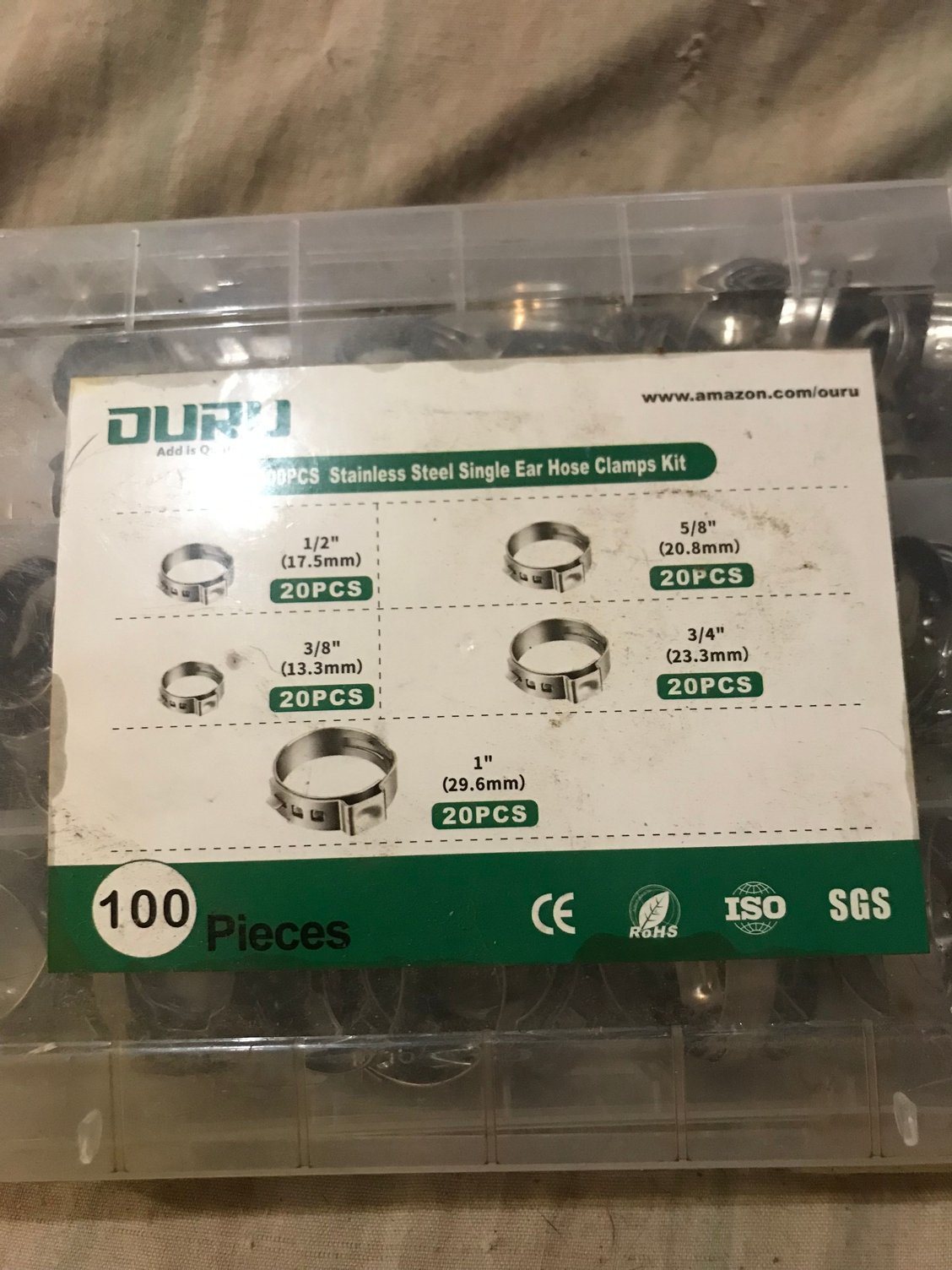

Mongo let us know how those pex clamps work from Amazon? I'm picking up 4ea OEM clamps tomorrow from the dealer.

Originally Posted by Cornpipe
Hey Buell I just read the reviews on those black Duru pex clamps and a lot of folks complained they are soft and break easy and leak. Probably made in China like everything else on Chinazon. If you know any other sources could you let us know?
I can’t speak for the black clamps but I use the same brand regular stainless
Without any issues,I use them with a good quality push lock hose and fittings.
With good push lock hoses and fittings they aren’t really even need, I just put them on for added insurance.
Cool, take pics.
Oh crap!
Just went back to check the reviews and found many issues with breaking and weak clamps. I canceled my order.
Cornpipe, If you are willing, please share the P/N of the HD crimps. I'll may try those.

Originally Posted by Mongo1958
Oh crap!
The part number for the HD Pinch clamps is 10354
Regarding clamps. You posted the video we made on them. We like the worm gear clamps because they are inexpensive and very reliable.
The second choice are the pinch clamps, which is what HD uses, and there are very few reports of hoses leaking with them....they are just not quite a secure as a properly tightened worm gear clamp.
The one time use clamps for Pex are not really made for rubber hose and it is not the easiest task to get them tight enough, but not too tight...and then they are more difficult to remove, even with the proper tool.
The nicest option are AN fittings, and we have more than a few Customers that have gone to Summit racing (or some other supply house) and gotten the fittings to pair up with our filter relo kits. I've pictured one of them below.
The reason we do not offer those as an option is that they add a pretty significant expense, and there are so many colors and variables to the set up, it would be impossible for us to stock are the variations. The few that are willing to spend the extra $ on them can get exactly what they want at a supply house.
Work drive clamps are junk IDK what anybody says junk.
Even Dan Moore who was one of the guys that started offering
These kits years ago realized this.
He sent fuel line clamps with his kit.
Any of the clamps mentioned will work.
Use what you want. I’m sticking with an fittings.
Not sure why DK is not offering the Parker fittings that came with the 3Guyz front down tube mount. Last I knew that’s who was supplying them. If they make there own now I’m not sure how they got around the patent cause it looks actually like the 3Guyz. Except they don’t use the 3Guyz engine oil filter adapter anymore.
