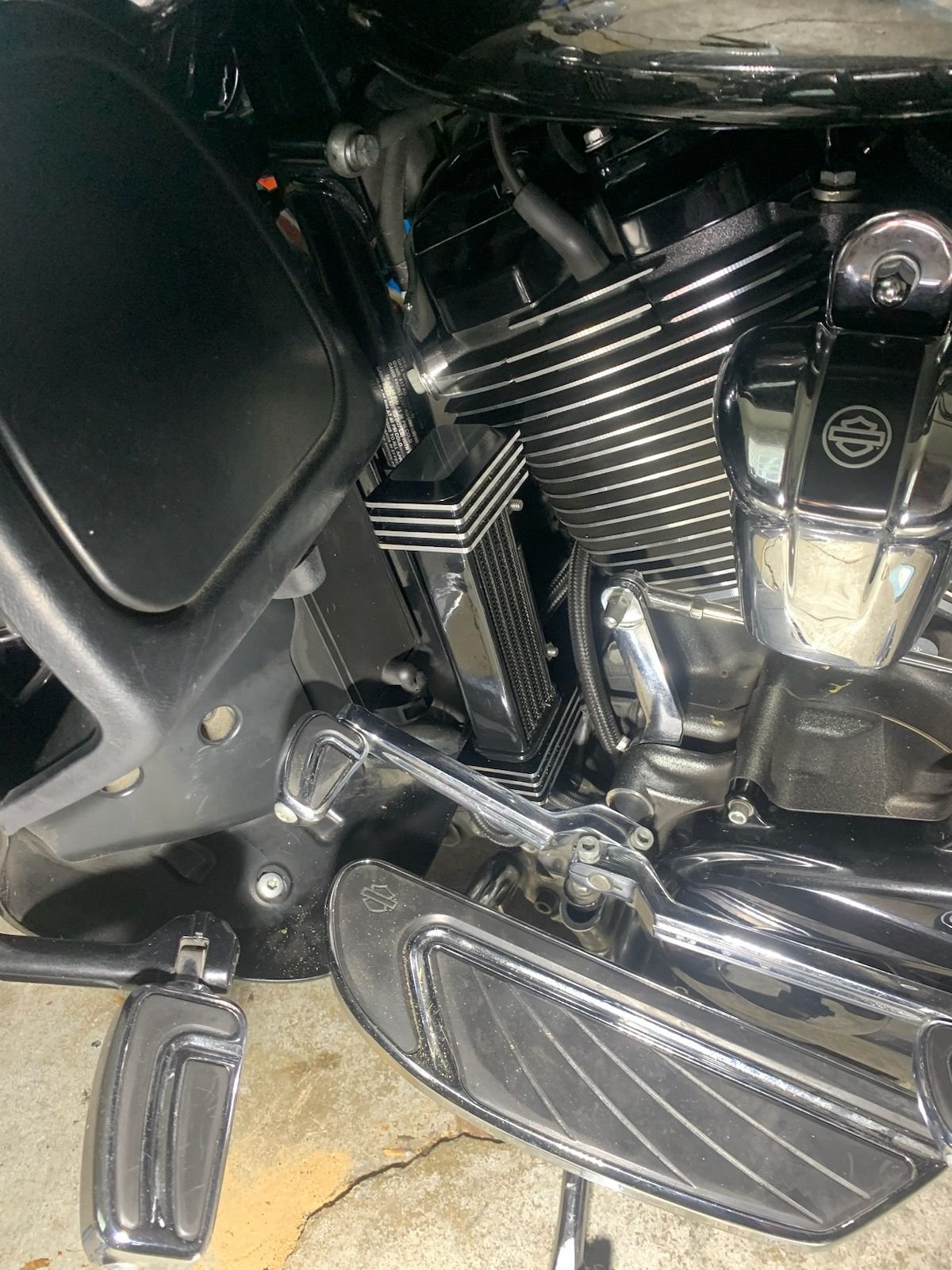

I put this up as a reminder to check clearance of your shift linkage assembly before putting in a cooler...mine was too far forward and would have knocked against the secondary oil radiator...it can be adjusted back giving you plenty of clearance.....this is either a 20 minute job or a 3 hour job.....below is another pic of the spline fitting....if you can get the fitting apart in that little nook and move it back and then reattach...you are golden....but that maneuver may also require you remove the all the stuff in front of it to get it done
