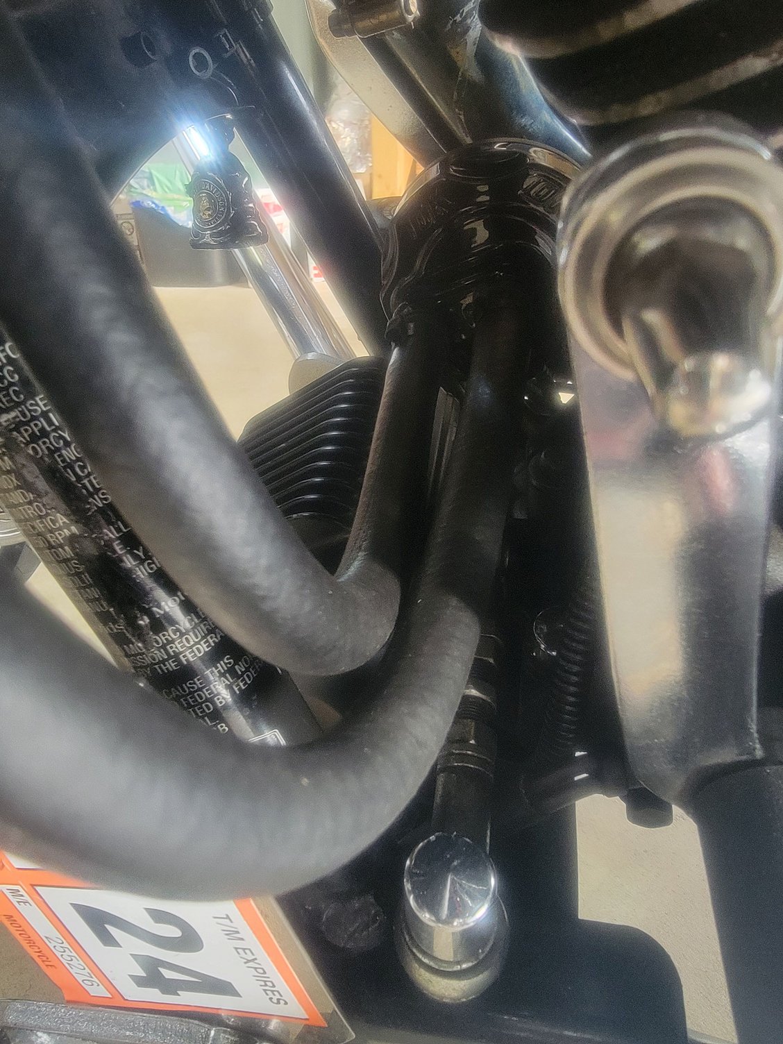

Just installed my third DK filter relo kit and the 2nd black one. I got lucky this time as the oil lines didn't cross each other because the puck on the engine tightened up and stopped at the perfect spot. I was disappointed to see they switched to plastic spacers and only one set to boot. My other two kits came with three sets of spacers of different thicknesses made of aluminum. Overall I'm very happy with the kit and great quality from DK. I used the HD pinch clamps instead of the hose clamps. I like the look much better.

Thanks Mongo, I had left over black steel braided hose I could have used but I wanted a more industrial look. Plus it's different from the black kit on the RKS. Did you get yours installed?

I like the look of that @Cornpipe
I’m going to run just the black hose, and black worm-gear hose clamps. All business, no bling.
Very Clean Install. Looks good! You already know how much nicer oil changes are going to be.
You should have received 2 sets of spacers, but it does look like you received the set you needed for your bike. Glad about that.
The "plastic" (hybrid nylon that will withstand up to 600 f) grips the downtube better than the aluminum, AND it does not mar the powder coat on the frame.

I used a set of the aluminum spacers I had leftover from my previous kits. The hybrid spacers wouldn't hold the filter adapter tight enough when I torqued the bolts down.
