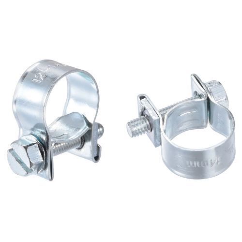

There's also fuel injection hose clamps

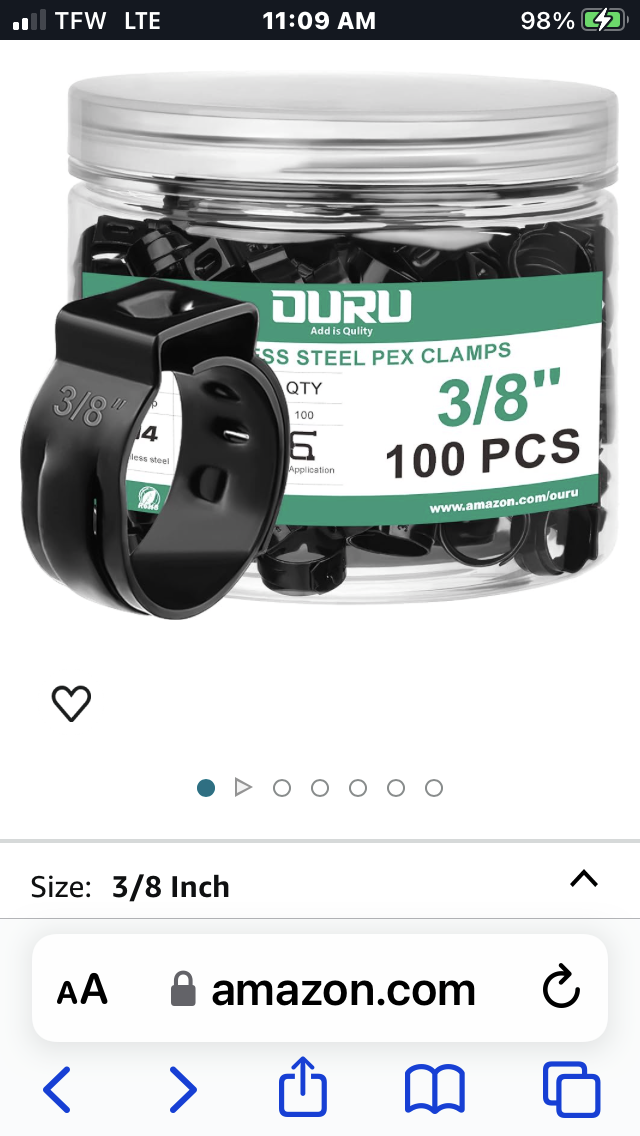

buell95's Avatar
buell95
Joined: Apr 2009
Posts: 2,191
Likes: 843
Originally Posted by Mongo1958
Just talked to DK Custom to find whet the diameter of the hose is (3/8"). So the worm clamp VS the pinch clamp.
Also found out that HD uses the pinch clamps as well on OEM oil coolers
There is an Ace Hardware in my Town so I can start there and see what they have. I wonder if there are black pinch clamps?
These from amazon
