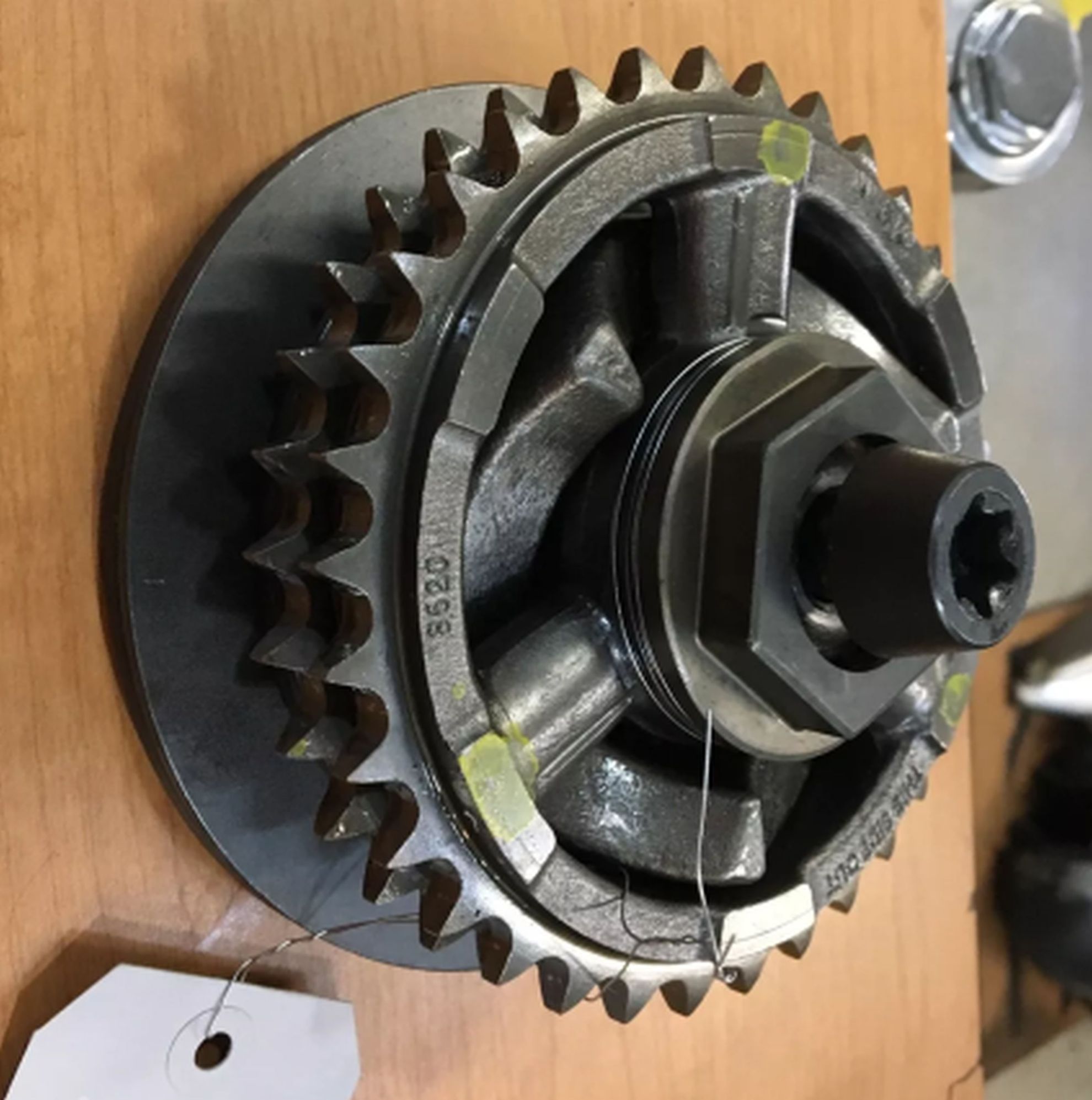

Originally Posted by hardheaded
I don't understand why HD changed the comps to start with . I have friends who have 96 and 124 S&S Evo engines that see burnouts and wheelies without any comp problems. Way more power than any twinkie or M8 has.
The comps, all the rubber isolator crap in the rear wheel and the slipper clutch were all designed to protect HD's loose machining and crappy flywheels in the engine.
Harley changed the compensator as well as utilizing isolation mounts to make a smoother riding motorcycle. The late compensator vs. the early style has more travel, and larger springs. To accommodate that they needed the springs on the inside near the motor and the sprocket away from the motor. That late design didn't allow for lube to sufficiently reach the center of the compensator. The latest HD compensator does get lube to the center of the compensator so they hold up very well. I run a 124 TC in front of the late HD compensator, no issues.
Early
Late

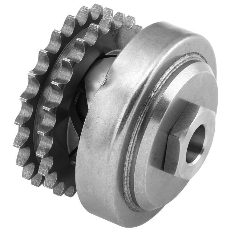

Originally Posted by Rounders
They are known to be a problem. That said I suspect it is riding style, I got 75k on mine, but ride like a wuss.
Cuious what direction he goes for fix. You got to epoxy pieces on for Harleys fix. Manowar has one, but has to be rebuilt 30-40k which is annoying. But maybe only for hard riders? There are threads with people with conflicting opinions.

Maybe I missed it somewhere in the conversation, but is the compensator actually damaged? You know you can buy the replacement rotor all by itself from Harley or aftermarket for around $160 and just put it all back together unless there is something more wrong. Those rotors are known for coming apart like that. I am on my third at 161,000 miles.
Old Sep 1, 2024 | 08:15 AM
  #39
flhf150's Avatar
flhf150
Joined: Jun 2008
Posts: 246
Likes: 37
From: Reading,Pa.
The picture shown is the cup that houses the bellville washers.
