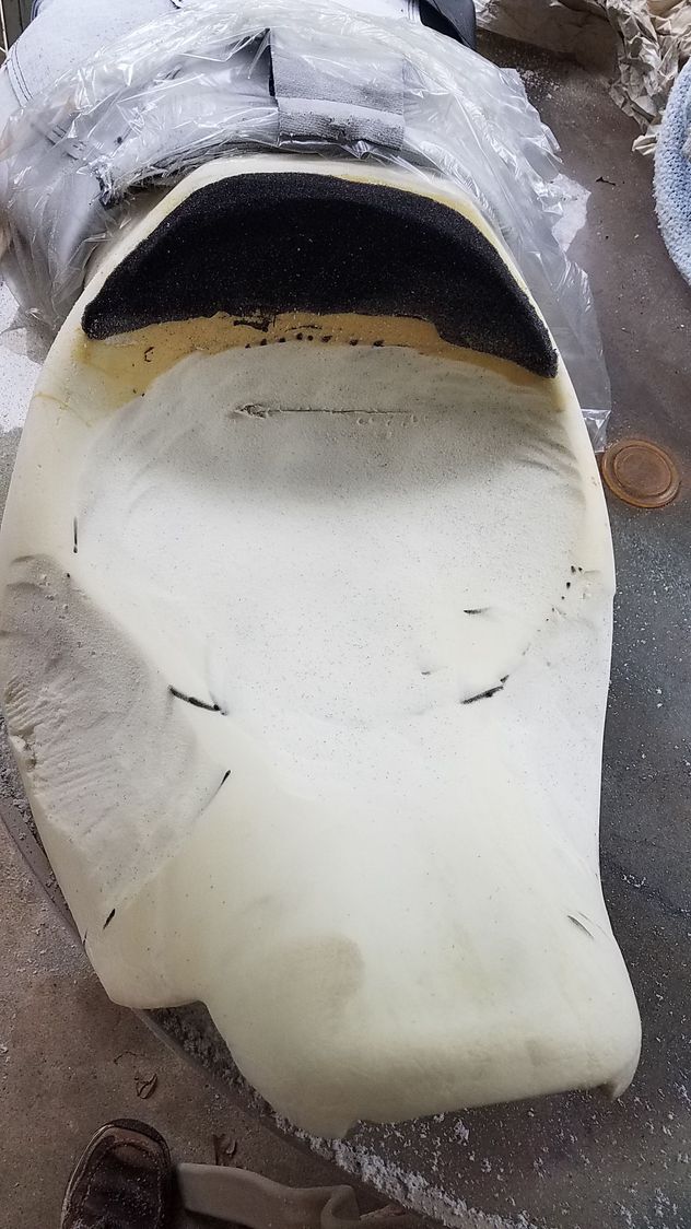

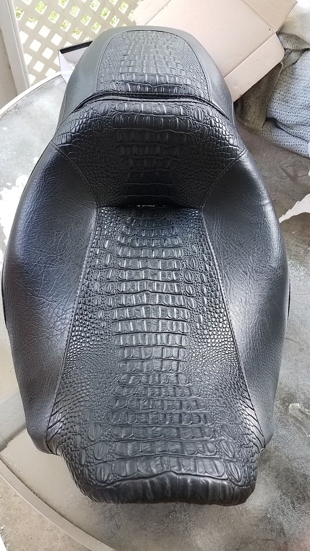

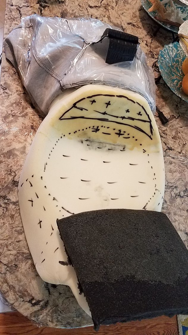

I truly like my Hammock seat but it is a little higher than I would like. I went online an did some research on shaping seats and what the objective is. I realized my stock SG seat is round the wrong way as it isn't shaped to support my butt. So I pulled my seat cover back and marked where I need added padding, where my legs needed support, where my legs were restricted from reaching the ground and lastly, where my butt's pressure points needed relieving.
Then I used an old electric carving knife, grinder and sanding block to remove what I wanted and cut, glued and shaped where I wanted extra padding.
Then I added a few layers of thin batting and put the cover back on. You can't tell I shaped it and the ride height didn't really change.
Cost: $0. Time: about 3 hours which half of that was messing with the contact cement.
Went for a nice ride. I now have more support on my thighs and my tail isn't nearly as sore after a couple of hours. I am happy.

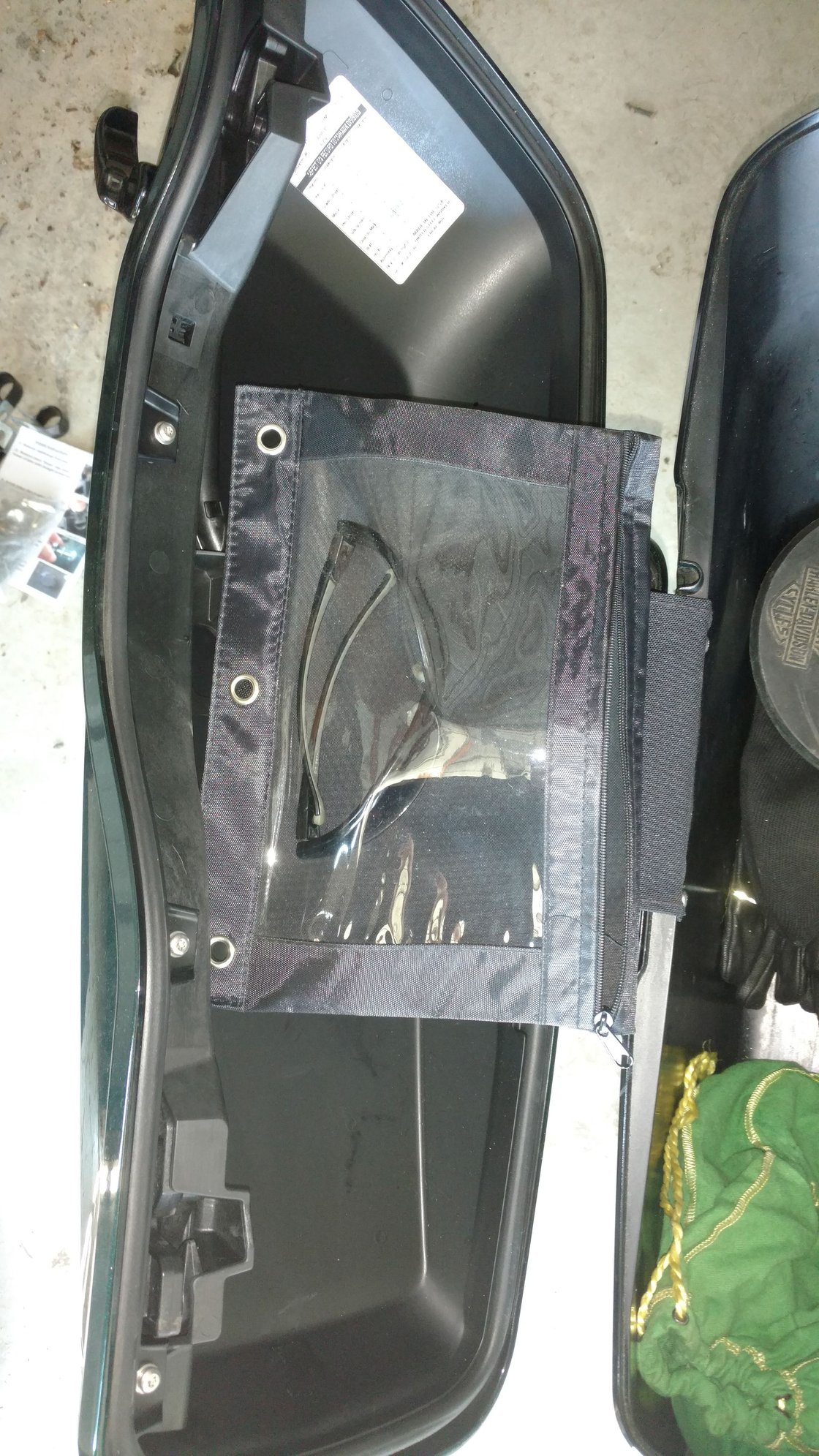

Saw somewhere in here that someone used p-clamps on the bolts for holding the saddlebags on to hold their glasses. I wasn't able to use the clamps cuz I have big ***** and it interfered with the clamp. So I found the quick clam ones with 3m tape on the back. Works good!
I also couldn't find a good lid organizer for the 14+ bags so I took a pencil bag (from my kids school supplies) and safety pinned it to the lid tether. Walla. Easy access to smaller items like keys, glasses, can koozie, etc.
