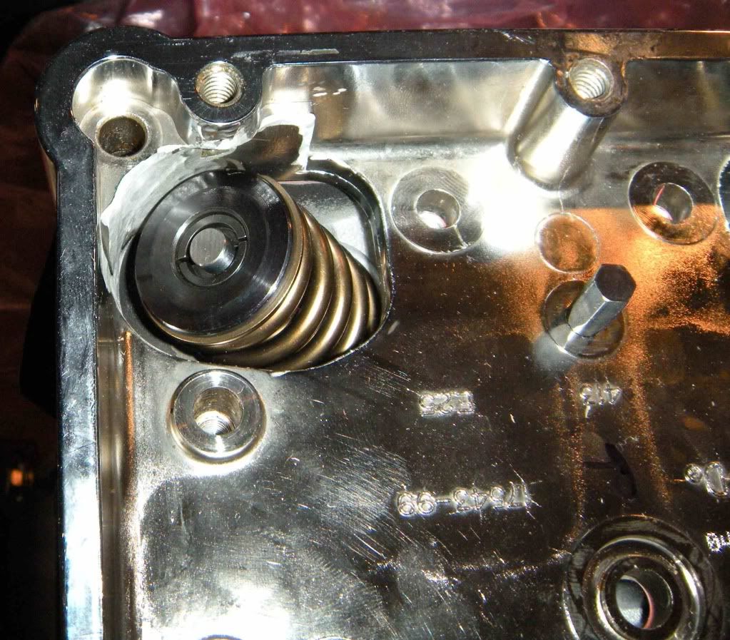

Again making slow but measurable progress....
Rocker box in place, with alignment pins "centering" the box on the head before torquing to spec. Also, notice the clearance between the top of the spring retainer & the rocker box. This is something to check & usually needs some additional breathing room.

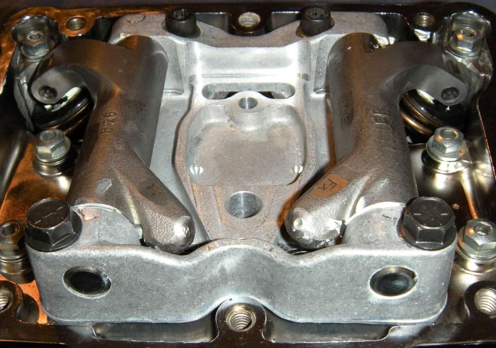

New rocker support plates.
New Baisley "Corrected Geometry" roller rockers. These are really nice!
May as well use new shafts with the new rockers & support plates…
Here are the front rockers installed into the support plate ready for install in their new home. Be sure to lube up the new bushings, shafts, rollers, & pushrod cups…
Don't overlook the o-ring between the rocker box & support plates...
Here they are in installed in the rocker box.
This is something I've poo-poo'd in the past, but got them on TR's recommendation. These things are pretty sweet too. The do change plumbing & way the oil separator circuit works.
Here's the box, ready for rocker covers.
