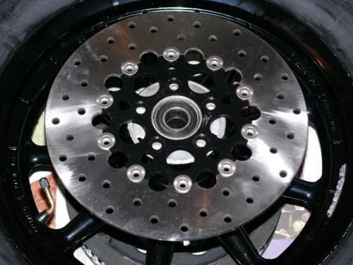

Well GR, care to reflect on your old post...would you change anything
BTW, What's up here?...Are those breakouts?
Yes, those are breakouts. The wheels are hollow castings, to reduce their weight and save metal, and those holes go into the void between the stud holes. The spokes are also hollow.

Really what I was saying...
Originally Posted by grbrown

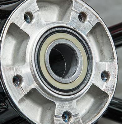

...Something I didn't expect is that the pattern of decorative holes in it exposes the internals of the hub, which means rain and road muck can get in there. Doesn't sound like a good idea to me! Anyone fitted these and had any problems with them in wet weather?
If there are are breakouts or areas open to the interior of the hub that when used with a rotor that allows "rain and road muck" to get in there, they should really be sealed. Could be like this.
But a lot of the OEM wheels have blind pockets and are not open to the inside so when using those with the same rotor a person has a choice whether to seal or not

The recesses in your top photo are not a problem and don't need any filling, although your photo in the other thread, with two breakouts, would IMHO. With my Deuce wheel I used two shim discs, which are a Harley accessory, as detailed above. The hollow inside that wheel could take a couple of quarts of water, at a guess!
