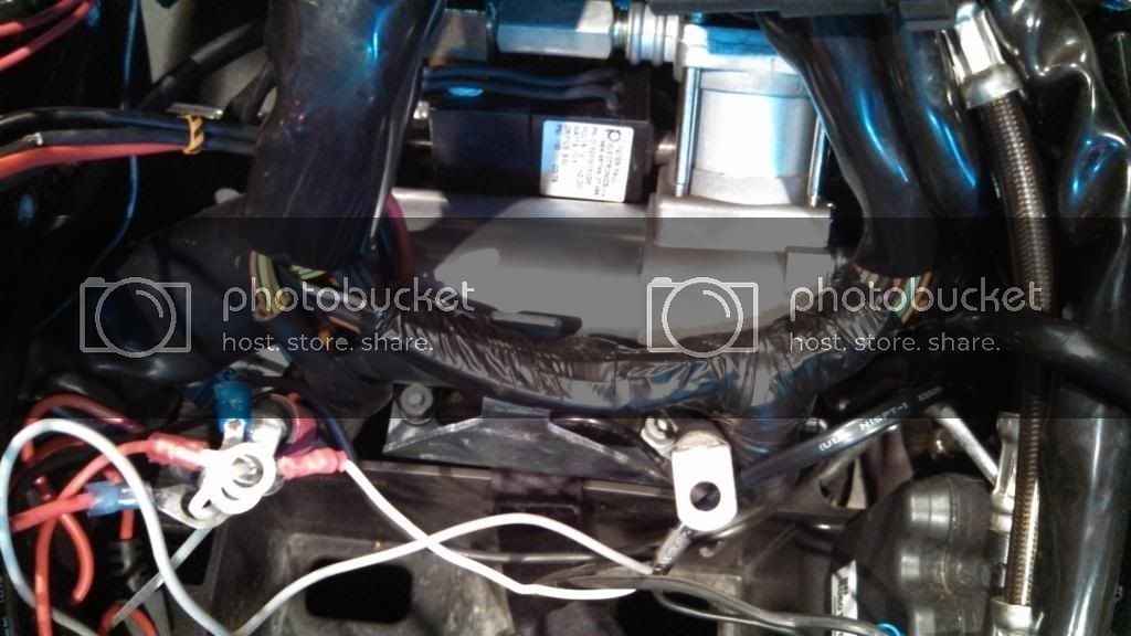

Does anyone have better info or pics on mounting the compressor in front of the battery tray??
Is the compressor just stuffed in there, or is it actually mounted to something?
I have a 2012 Ultra Limited with ABS and am trying to figure out where to mount my compressor. I am thinking in front of the battery or get a mount for behind the right saddlebag.
Not sure if this would be helpful or not, since I am not familiar with the 2012 setup, but here is a video of an air ride install with a compressor under the ABS.
https://www.allboutcustomz.com/videos/
Go to install video then 1:28 is where he starts the compressor install.
If this video isn't right for your scooter, then my apologies.
That's actually perfect. Thank you!!
Glad to help, that is the exact spot I put mine.
