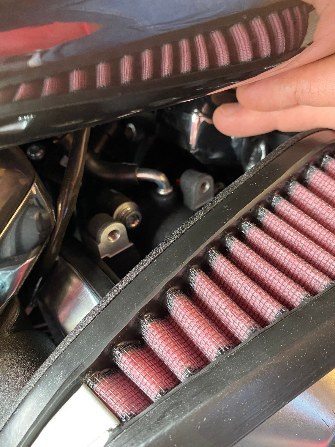

Just installed my wedge style high flow filter on a 2020 Road Glide Special. Read the forums, watched You tube, and unbolted the rear of the gas tank and propped it up as suggested.
Well the induction module bracket is attached by two Hex fasteners (5mm) and are easily accessed horizontally. No need to move the gas tank.
Behind the newly installed filter, both attachment points where the induction module bracket was.
