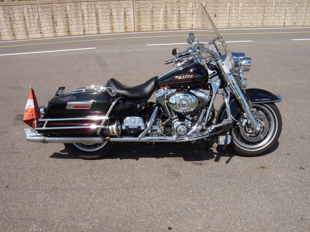

Well, I made my decision and decided to go with the 2000 Road King with 18000 miles on it. It was in awesome condition, same condition as most 08's I've seen around town.
Of course its original paint so the luster is probably not as nice but overall I'm very happy about it.
John
