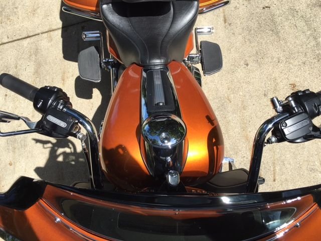

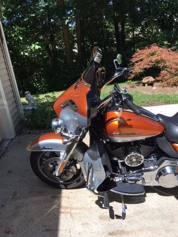

I know this is an older thread, but I referred to it as I was making my decision on new bars for my 2014 Ultra Ltd. I'm 5'9" and have lowered HD front suspension, and Ohlin 3-3's from Howard on the rear, set to the lowest height. I also have a midrider seat from Ultimate Seats.
It has taken me about 3 days to get used to the sweepers. It was an especially big change for me, as I had my stock bars rolled back about as far as they would go. And they are wide... I can't believe how much width 2.5" really adds. I'm starting to like them, but haven't gotten a good long ride in yet.
I wanted to post some pics that may help others to know exactly what to expect, so I included pics from several angles. Hope this helps!
p.s. my installer was able to run all switch wires and oem heated grip wires inside the bars, I just had to buy a 10" wire extension kit from HD, which was around $25. Stock brake and clutch hoses were fine, although I think he rerouted them a bit.
Definitely not stock, but not ape hangers either.
View from the luggage rack.
They are set about as high as they can go, which at the top of the fairing pockets puts the bar about 1/4" away.
This picture is taken from the vantage point of my eyes as I'm sitting on the bike.
