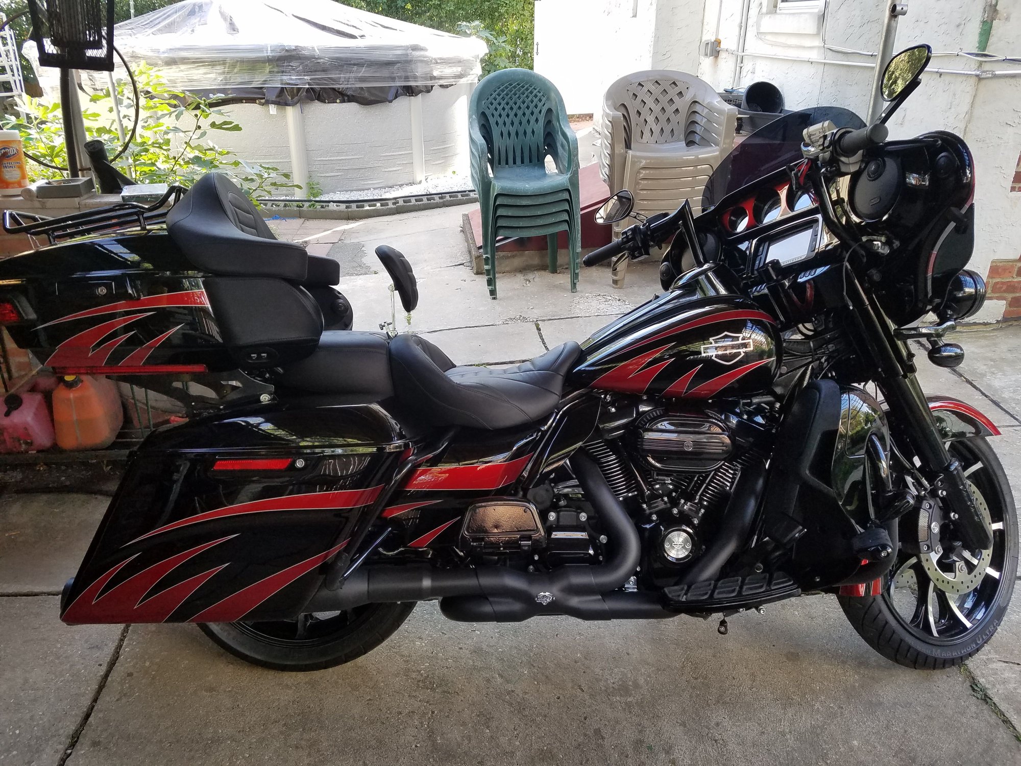

I have a 18 ultra limited with a 200/55/18 metzler on rear, got bike built for me vs spending 50k on a cvo. When I go faster than 90 I get a wobble on the back. It happens on straightaways. I don't know if I should change the rear back to stock 180 or change my suspension. Any recommendations?
