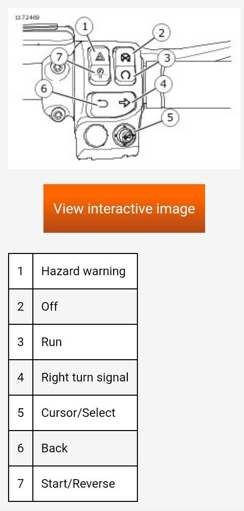

Originally Posted by sloufoot
Correct, the 4way flashers stay on until canceled out with the turn signal switches. Switch on & both held in at the same time for about 5 seconds. The switch can be on or off, it doesn't matter once the 4 ways are activated.
The OP has a 2019. The 4ways are no longer activated/deactivated with the turn signal switches. The Hazard warning (4way) switch is on the right hand controls.
