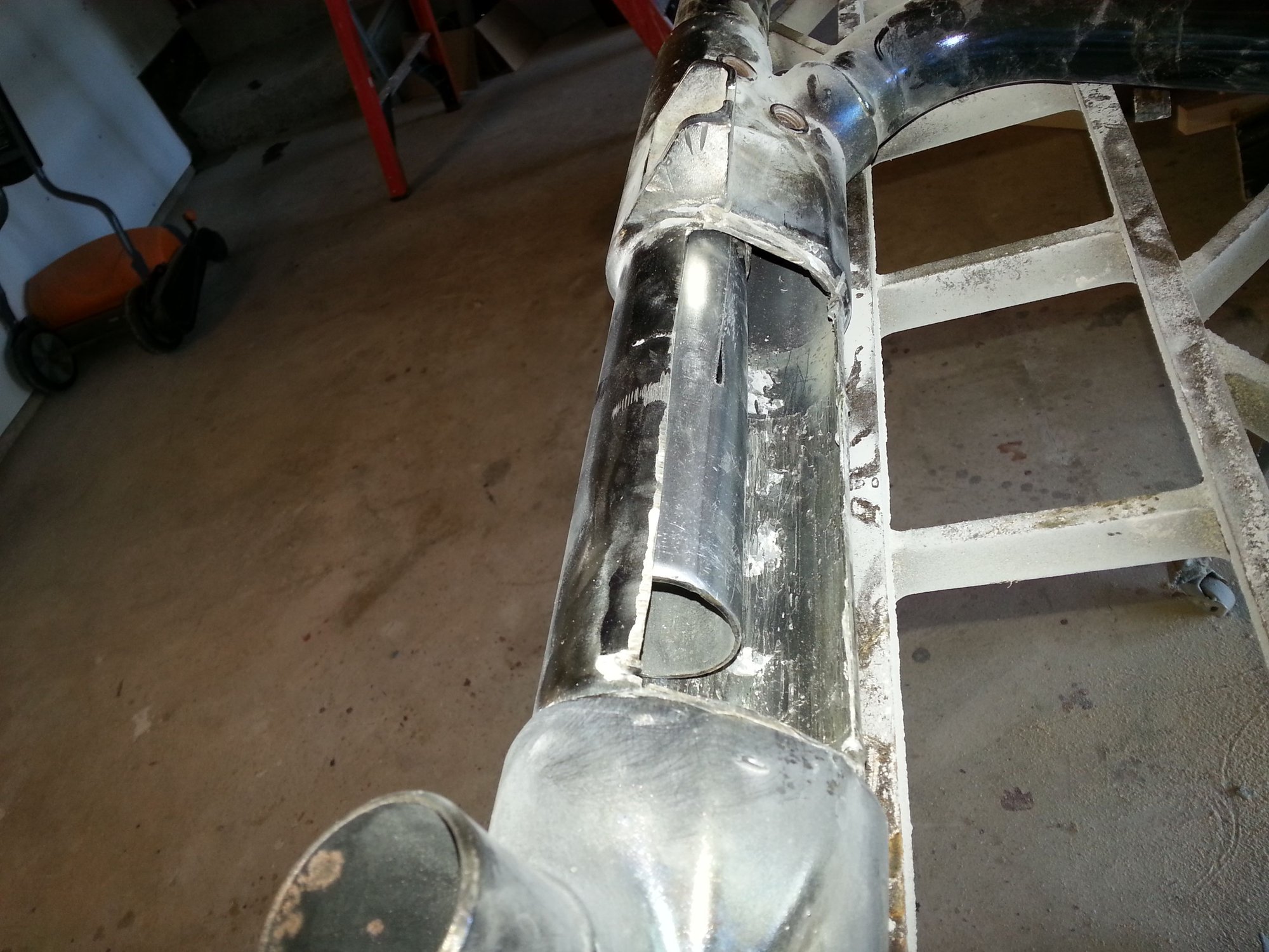

Collector Modification
good idea or waste of time.
thinking this might help it not sound like pooh..........
I will be cleaning the collector better before final assembly
1 1\2 OD pipe with one end stretched to about 1 5\8 OD
Thanks
Ed

Drilling it out wont get it all out. Its made of a soft metal material not a old brick style. I thought i could drive a rod thru it and break it out no suck luck. I cant see how a drill will remove it all either. I cut mine in half with a offset cut into the center so I could easily re-clock it back to factory clock and then had it tig welded at work. You cant even tell i opened it up unless i point it out. Way less heat and runs fine. No cross talk that i can feel in the seat of the pants dyno either.
Batman.

When I decatted my OEM, I also added a 7" x 1 3/4 piece of pipe inside the chamber. The sound was much improved, but the heat was still there until I had it tuned. Runs and sound great now.
