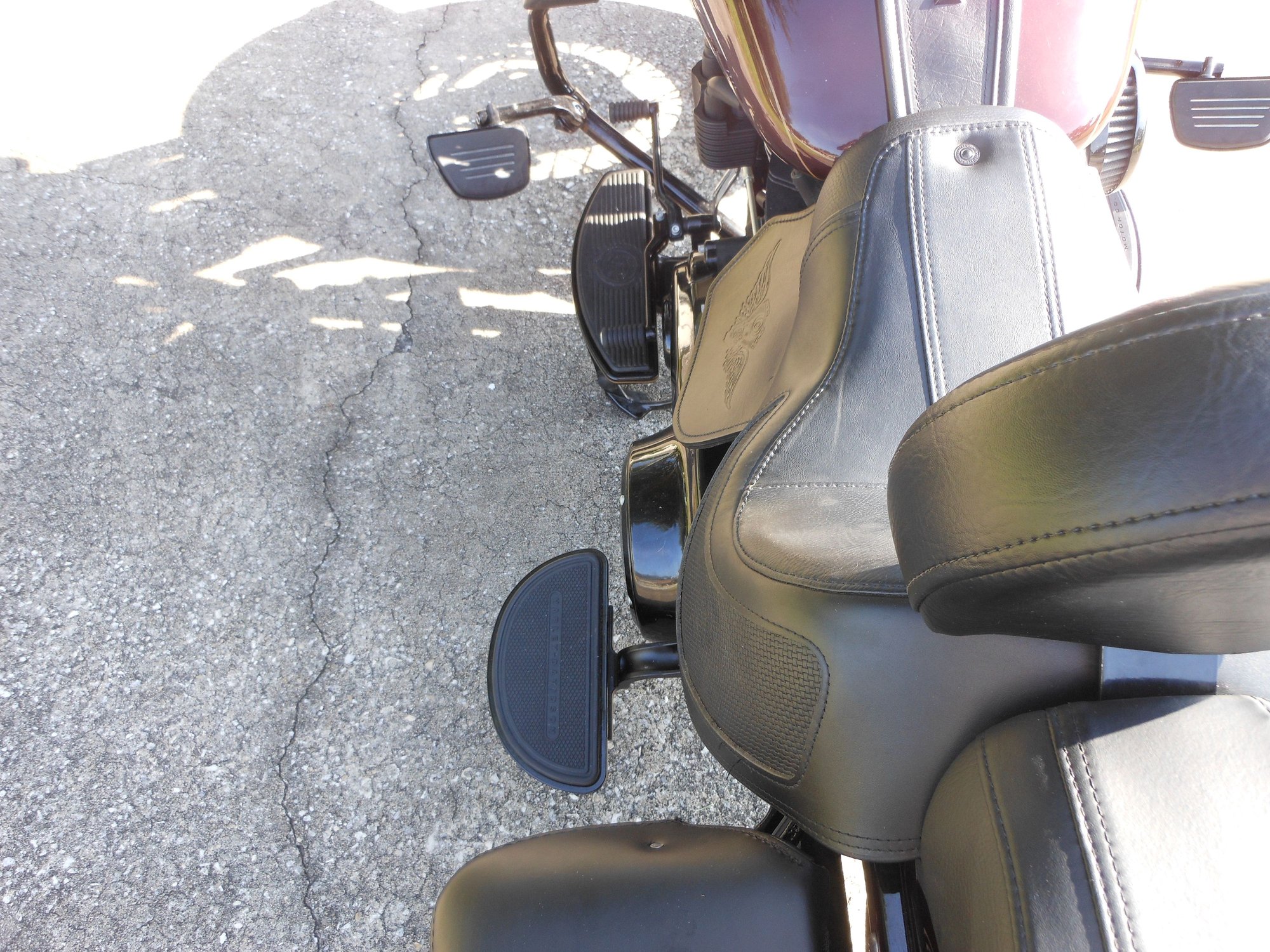

Originally Posted by FrankEV
Follow up as promised
Right side
Everything is dry fit on the bike and my lady is happy. Tomorrow I take it apart again, touch up all bare steel with black touch up paint and do a final reinstall using Blue Lock-tite and make sure the new bolts are tight.
I guess I lucked out!
is the floorboard actually touching the cover ? that's going to wear off paint over time if it is .
i sure hope your wife appreciates all the work you're doing to make her ride more comfortable !

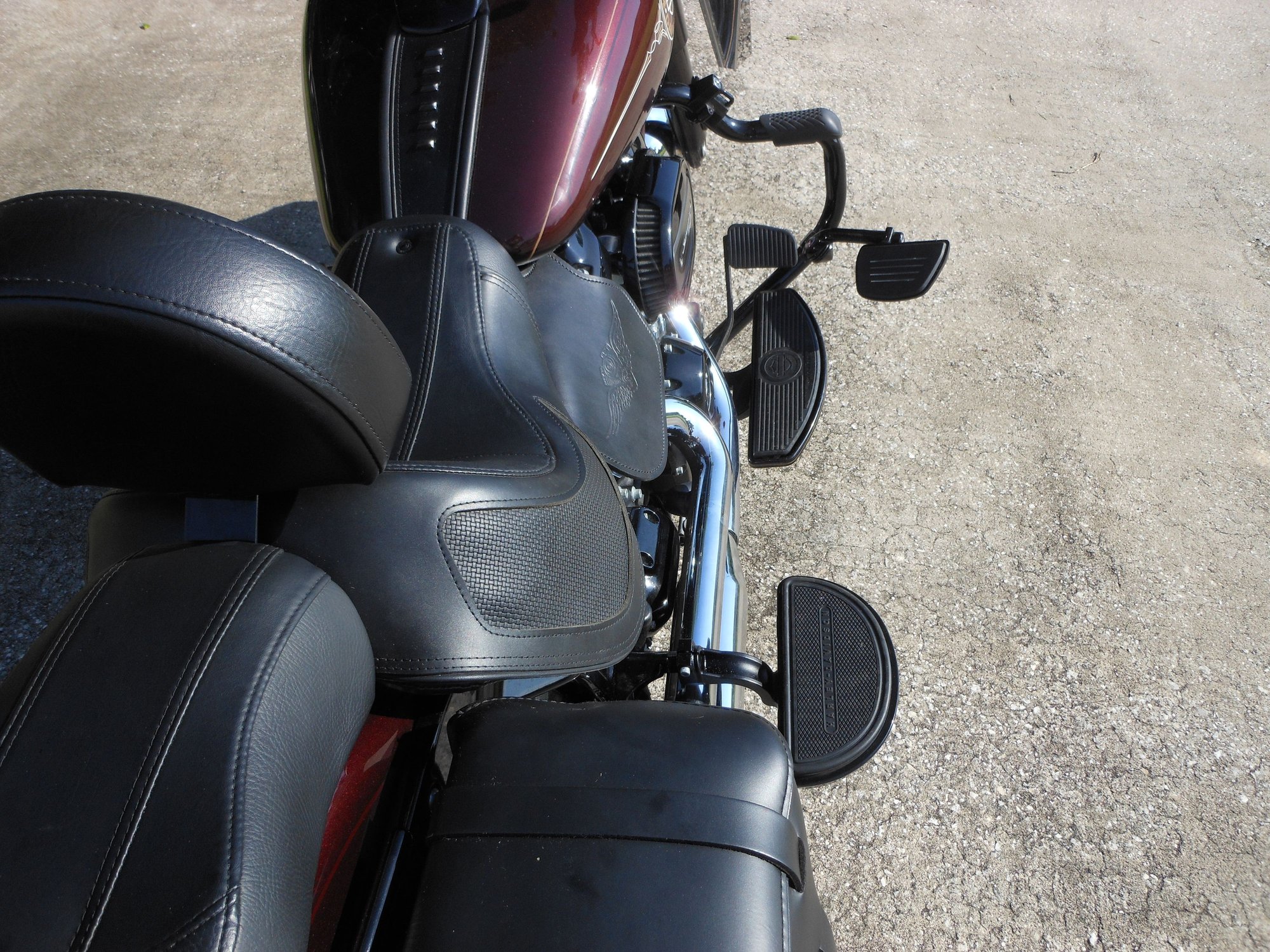

No, it does not touch.
Left side, final install
Right side final install
Just noticed that when backing the bike up (which have to do to get out from under my carport each time) my legs hit the boards. Not a big deal, but something I will have to learn to live with. Still quite happy the way the install turned out.
BTW, If she was my wife, I probably would have told her to live with the foot pegs...but a SO is another story.
