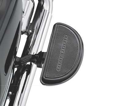

I found these passenger foot boards (H-D Part no. 50810-08 $179.95) complete with supports (H-D Part no. 50400-071 $149.95) at a swap meet yesterday and paid $150. They fit a number of prior model year Softail’s including the 2017 Deluxe. I wasn’t sure they would fit, but I took the chance and bought them.
H-D 50810-08 H-D Part 50400-07A

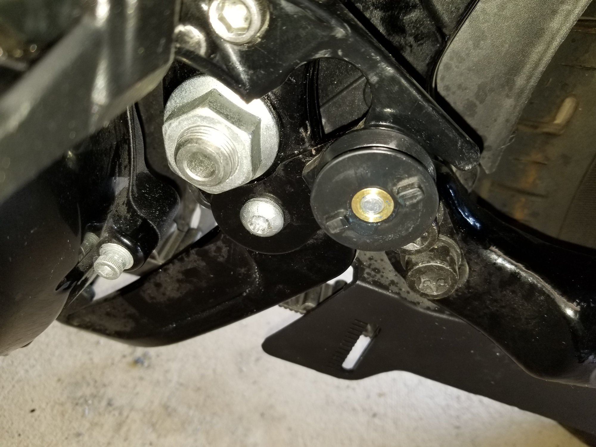

As I mentioned in my previous post, I attempted to remove the existing right side passenger peg post but could not break lose the bolt holding it into the frame. In trying to break it free, I messed up the Allen Wench socket head. Since the bolt is recessed deep inside the peg post there was no way to get any kind of vice grip on it. So I decided to drill it out. It was a beast of a job but I managed. I had to buy a 9/16” dia. drill bit because a ˝” bit just wasn’t quite large enough to remove the full bolt head.
I used a series of drill bits from small to large cooled with WD-40 to drill out the bolt head. High speed drilling eats up drill bits as you all are probably aware.
Once the bolt head was removed, the peg slipped off easily and I was left with the headless bolt projecting from the bike frame. It took extreme clamping power to fix a vice grip to the bolt and I had all I could do to back the bolt out. The Lock-tite they used was not red, but it sure held it very tightly.
I use a new Stainless Steel Allen Wrench Socket Head bolt to mount the new right side passenger foot board support. There were no interferences on the right side and the U-shape portion of the support bracket fit nicely around steel plate behind the right side rubber v-mount saddle bag brace connector.
Moving to the left side, I tried for a few minutes to break the bolt free but to no avail. So I went straight to the drill out procedure. Again a beast of a job, but things went a little faster since I kind of knew what I doing. Once the peg was removed I used the vice grips again to back out the bolt. However this side was even more difficult to back the bolt out, but with a lot of grunting and cursing I finally got it out. I was running out of steam, hot and sweaty and getting very tired by this time.

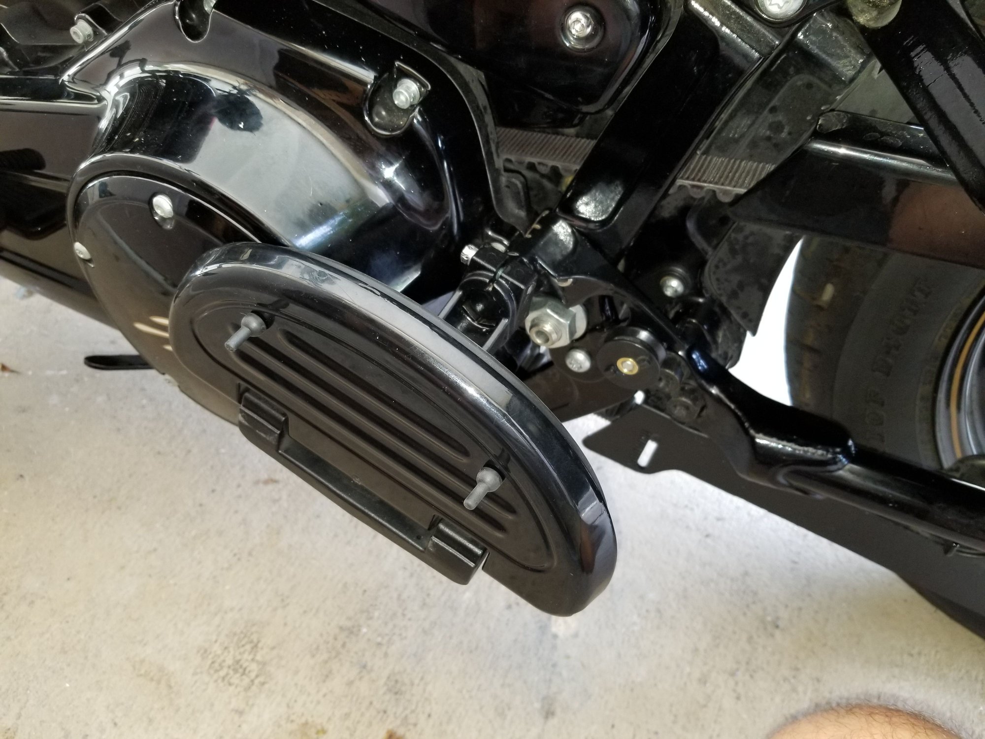

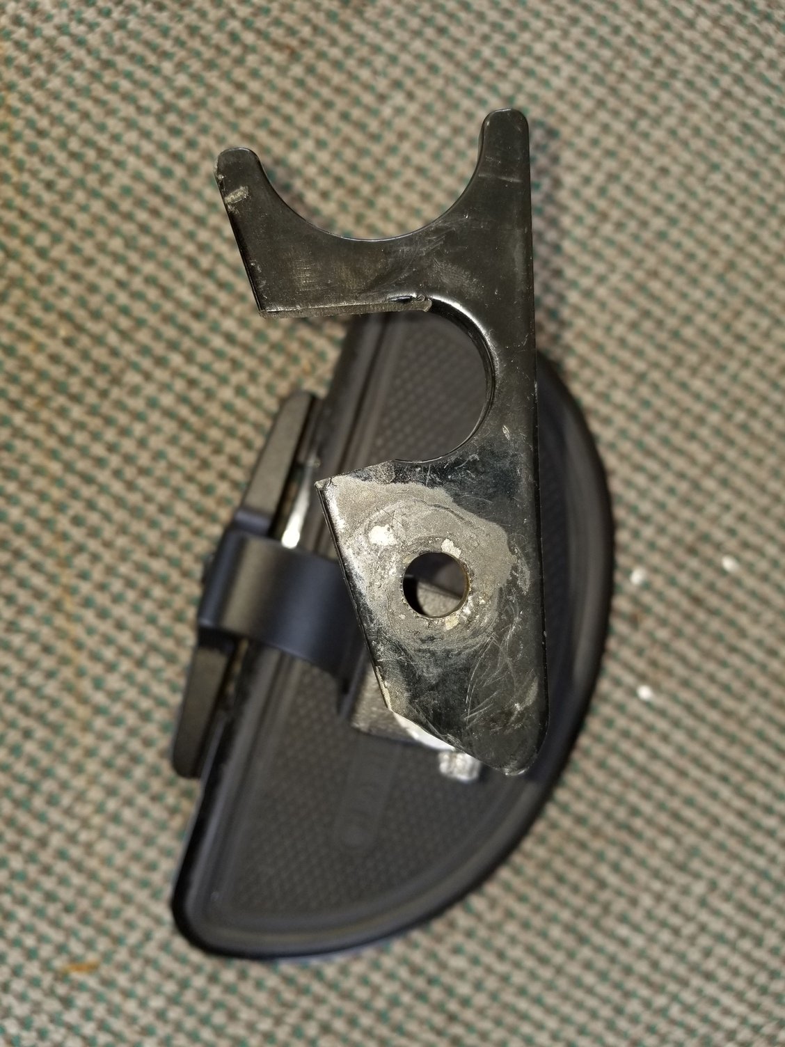

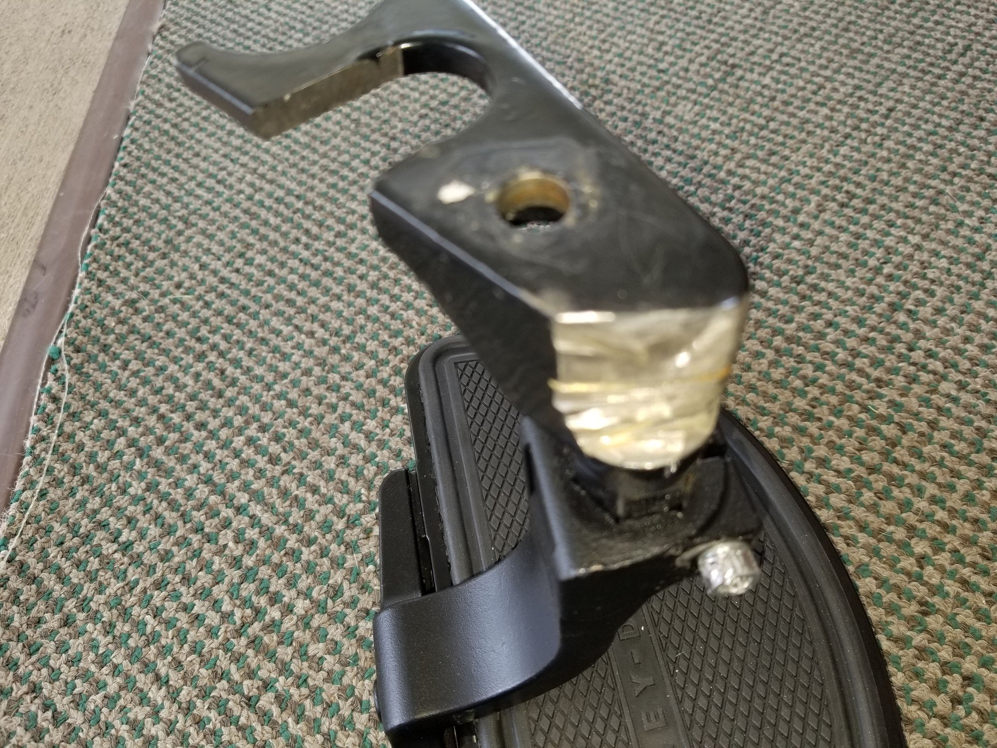

Not quite so lucky with fit on the left side. The transmission housing and the large pivot shaft nut interferes with the passenger foot board support. Additionally, the u-shape portion of the support does not align with the saddle bag brace mount as it did on the right side.
To clear the interferences, I had to grind away portions of the support so it would lay flat against the frame (see photo’s). I removed the saddle bag brace rubber v-mount and reinstalled it with a longer bolt clamping the u-shape portion of the support between the bike frame and the v-mount. This bolt also served to prevent the support from rotating when the foot board is stood on. Again, I use a new Stainless Steel Allen Wrench Socket Head bolt to mount the new left side passenger foot board support.
Right side
Left side
Left support modified
Left support ground away to clear transmission housing
Close up of Left side support installed
Left side flipped up
Everything is dry fit on the bike and my lady is happy. Tomorrow I take it apart again, touch up all bare steel with black touch up paint and do a final reinstall using Blue Lock-tite and make sure the new bolts are tight.
