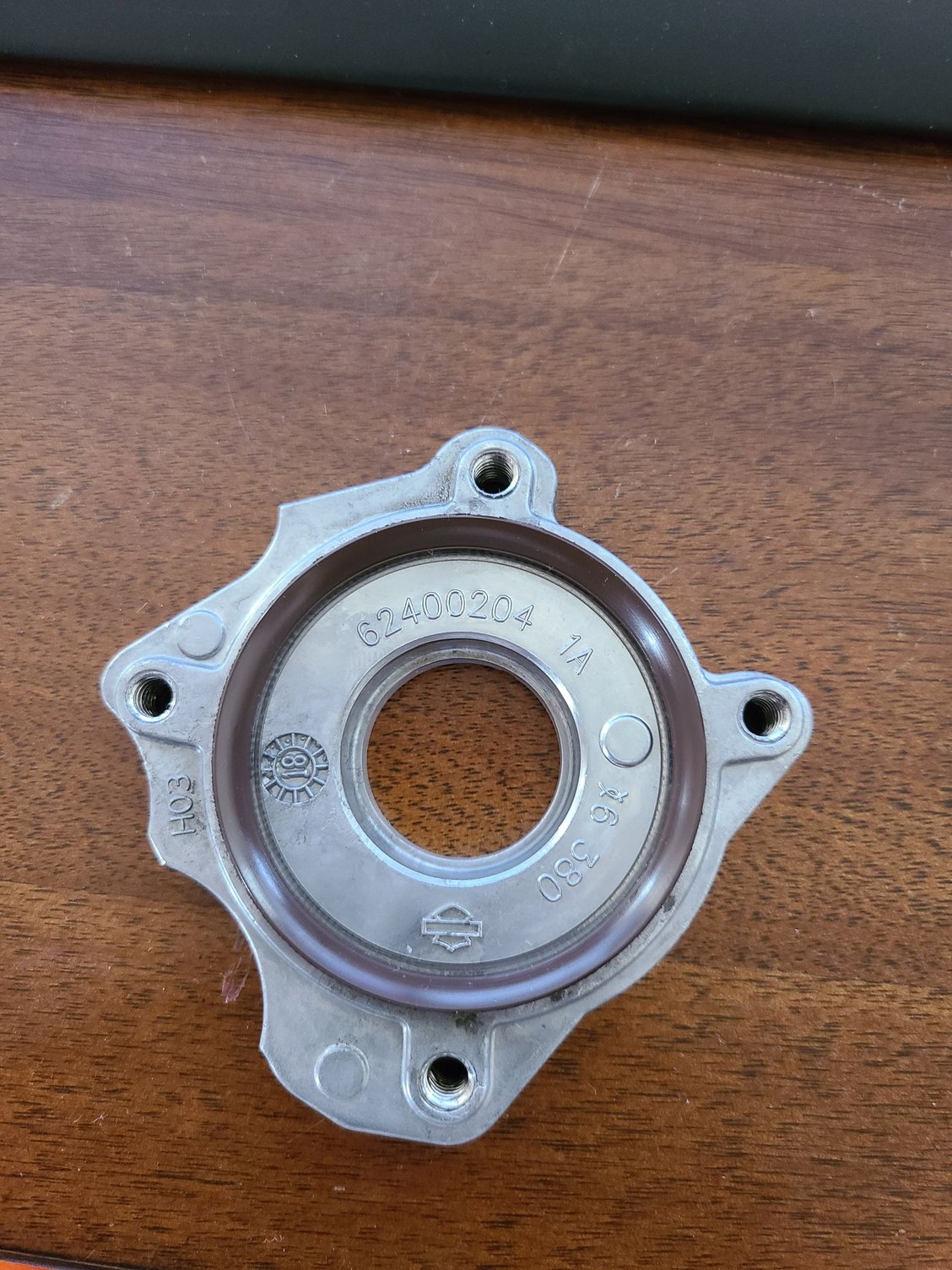

Wink Fat bob oil pump plate
Originally Posted by Bowhunter8607
What year is your bike? Just curious because if it's an 18 or early 19, there's a fix for the excessive oil out of the breathers. Mine was covered under warranty and HD knows about this issue.
I had so much oil coming out of the breathers it was saturating my air cleaner and dripping all over the side of the bike. At the 1000 mile service, they suspected faulty breather valves so replaced those. 10 miles down the road the oil is puking out still.
I turned around and took it right back to them. They called HD tech services for assistance and with that found the issue. The 18's and some early 19's came with an oil pump back plate that had a seperate oring. They modified this plate with an attached seal. They also replaced the cylinders and pistons due to the amount of oil build up from sucking in a ton of that oil.
After that, not a drop of oil out of my breathers even with the oil at the full mark. Don't just put a bandaid on the issue as it's still there. You just simply rerouted the oil. It's an easy fix. Here's the upgraded oil pump back plate.
Is there a part number for this and installation instructions?
