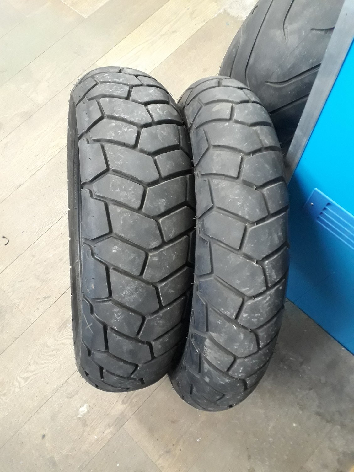

badass! looks great! did the tires fit with no issue? Im thinking of doing the same
Old May 6, 2021 | 02:09 PM
  #1122
ro0Ster's Avatar
ro0Ster
Joined: Jul 2020
Posts: 108
Likes: 33
From: Ontario, Canada
I have to say, those tires look very nice compared to stock.
I still have plenty of meat left on mine, but I'll look to do the same thing when the time comes..
Old May 7, 2021 | 12:47 AM
  #1123
MoneyFor's Avatar
MoneyFor
Joined: Feb 2017
Posts: 2,583
Likes: 1,029
From: East Flanders - Belgium
No issues at all, go for it.
Mine where not gone either but why wait as you can enjoy it now.

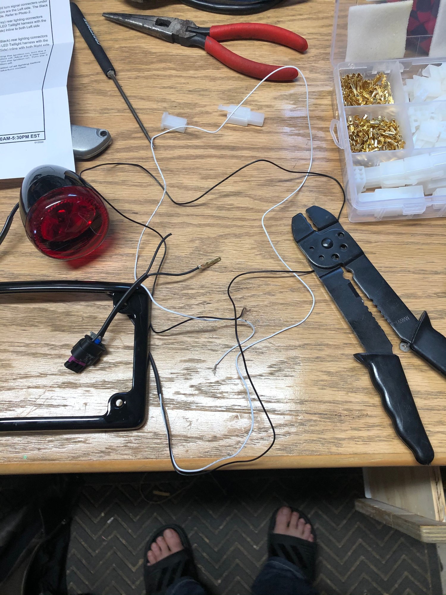

Wound you mind posting pics of what the wiring under the fender looks like and how/where you connected it under the fender? I received a Cycle Visions license plate relocation bracket and Custom Dynamics led taillight as a bday gift. I’m attempting to install them myself but I’m new at all this (but I’m enjoying learning how to work on my bike myself). The taillight seems simple to connect but the plate light is another story. How did you connect the taillight wires? I’m not sure if I depin or not. I looked online and viewed videos but the plug they show looks nothing like the plug for the plate light. Help would be much appreciated!
btw, my bike is a 2020 fat bob.
Thanks!
i replied to one post even tho a lot of people have done this, so a response from anyone would be great.

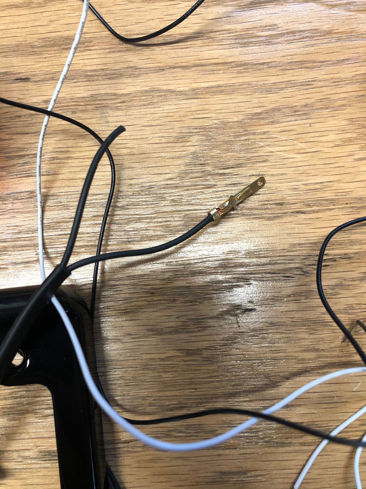

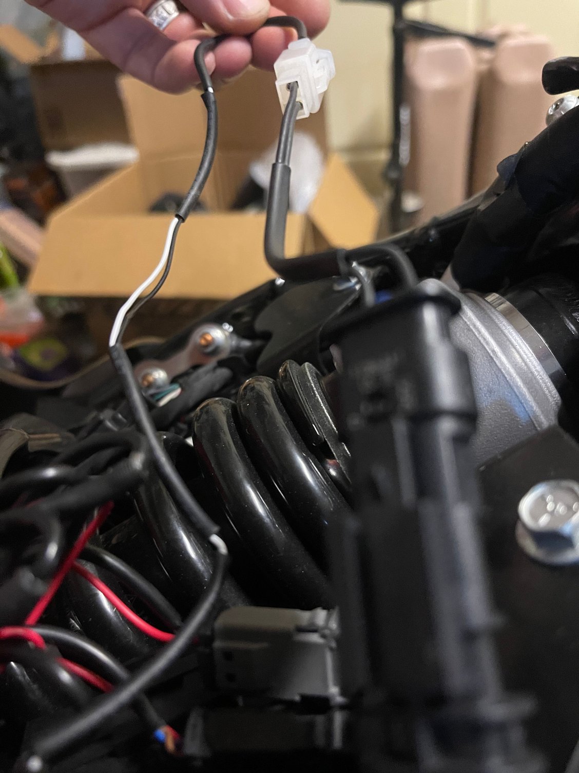

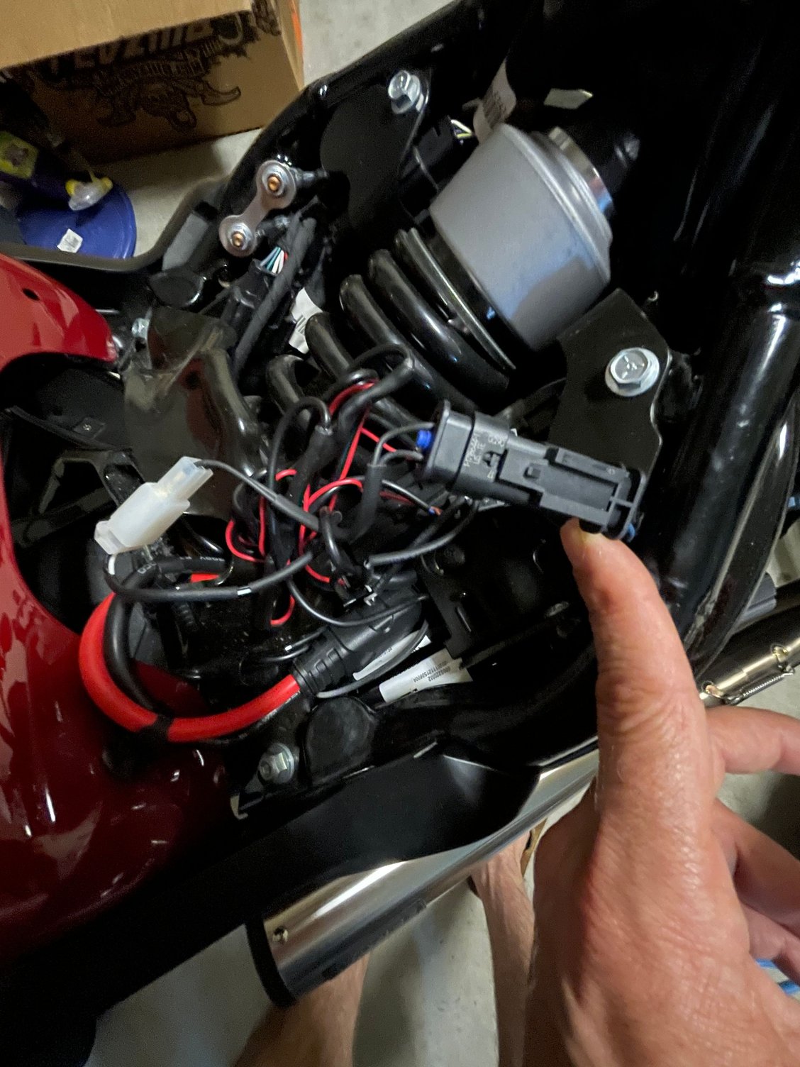

I cut the wire from the stock connector to the OE LP light about 4-5 inches back from the connector to the light. I then used a wire connector kit, I already had, to crimp pins and attach to to 2-wire connector. I did this on both sides to connect the Custom Dynamics wires to the wires from the stock wiring harness (it’s the white/clear connector in the pictures).
In lieu of having a wire connector kit like mine, you could twist the wires together and electrical tape them, or if you have shrink tubing with heat gun activated solder that’d work too. Basically any way to reliably connect the two sets of tails of the wires together.
