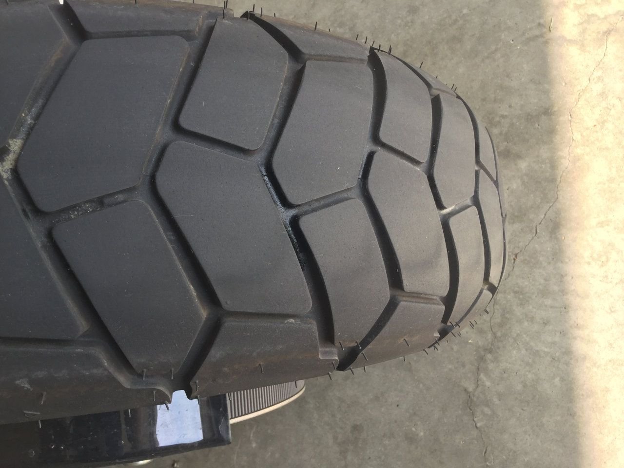

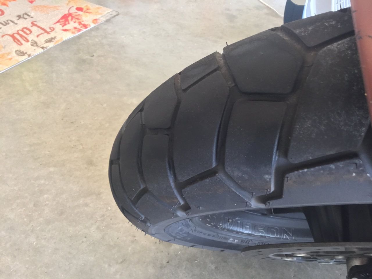

At 10K miles, the front tire is at 5/32" and the rear is at 6/32". The front tire is scalloped on the left side severely, probably from my trip to the "snake" last week. The rear tire is squared off a bit but it still looks okay.
At 15K miles the original tires are now at 4/32" for the front and 4.5/32" for the rear. The front tire scalloping is now equal on both sides and is very severe, but there is plenty of tread.

Finding a multi compound rear tire would help with the squaring off of the tire. The torque is the blame for that.
