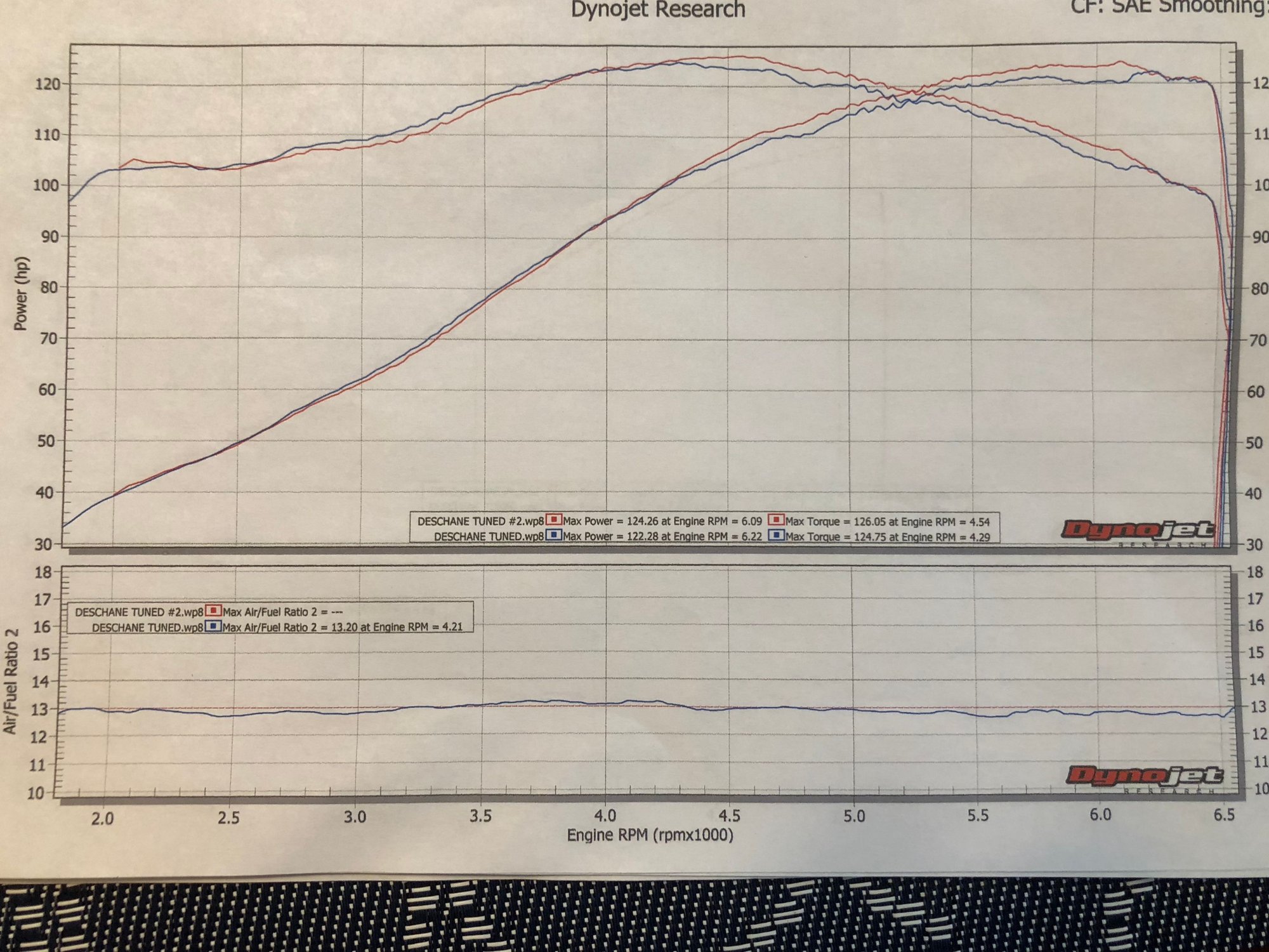

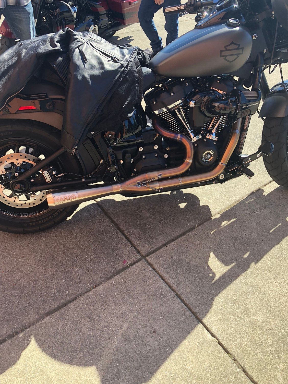

my exhaust is finally installed and dyno tuned with power vision. Amazing how the power vision really wakes up the bike compared to the SE tuner. Here’s the setup and chart.
Complete se stage IV kit
heavybreather ac
fab28 2-1 exhaust
power vision tuner.
final #’s 124hp 126tq.

Nice numbers! Must be fun to ride.
But, some questions.....you have the Stage IV kit, so IIRC it's now a 117" motor with the CNC ported heads and presumably a bigger throttle body? Does your bike have the Power or Torque cam - or is it a totally different cam for the Stage IV kit?
I have only the Stage 2 (torque) cam, Bassani RR3 exhaust and Heavy Breather AC on my 114" bike and I get the same 126 ft lbs TQ, but my peak torque is at 3.6K RPM vs your at 4.5k RPM. You do get 14 more HP at the top end though :-) And it looks like from about 4K RPM your HP curve is higher than mine.
So my conclusion here is that the Stage IV kit properly tuned will walk away from my Stage II bike after 4K RPM, but up until then I will probably be faster.
Very interesting. My dyno chart is below for comparison.....

yes the stage IV kit is a 117” ported heads, 64mm throttlebody 5.5 injectors.
The cam is a SE-515. Def an upper range cam.
I’m happy with the numbers but being the tinkerer I am I will be swapping the cam out at some point. Just can’t decide if I want to do a 124 kit at the same time.
