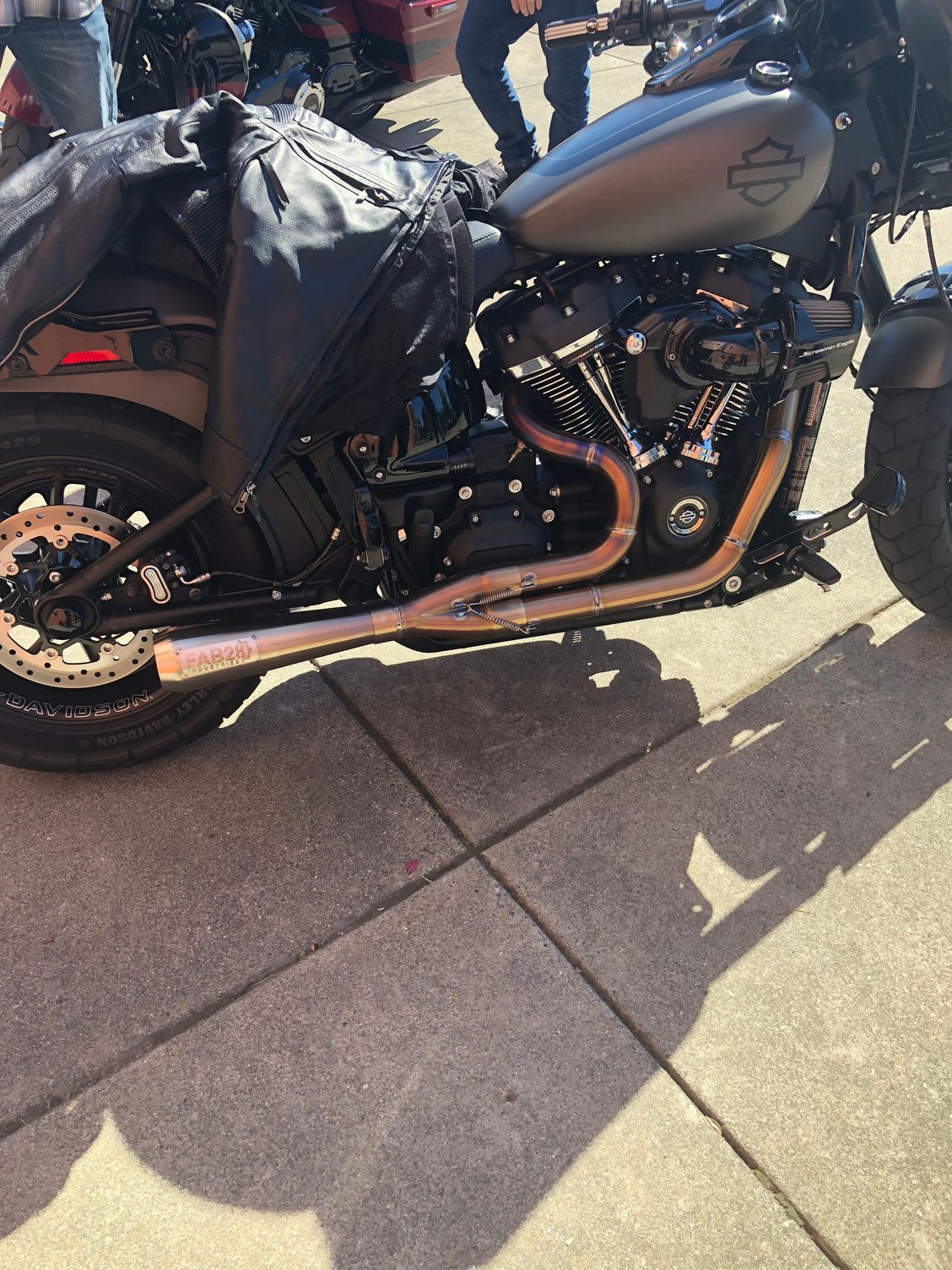

Default New build dyno
Just finished my new setup and got her on the dyno.
Final # 144hp. 138tq
Complete harley stage IV 117
harley extreme heavy breather
fab28 2-1
ward performance ported manifold
ward performance reworked the S.E. cnc heads that came with stage IV kit.
Wood 408 cam
Forgot to add that it is going back in in a week to add a power commander with the powervision because we needed to tweak a few spots where the powervision resolution wasn't fine enough as well as so other things that need fine tuned that the we just ran out of ability with the pv.

Very nice!! Congrats with your build. Can you please post a pic of your bike with your exhaust set up.

Here is an older pic before the ward stuff, cam, and intake

Looks good! Thank you for posting. Keep us posted on your retune results..
