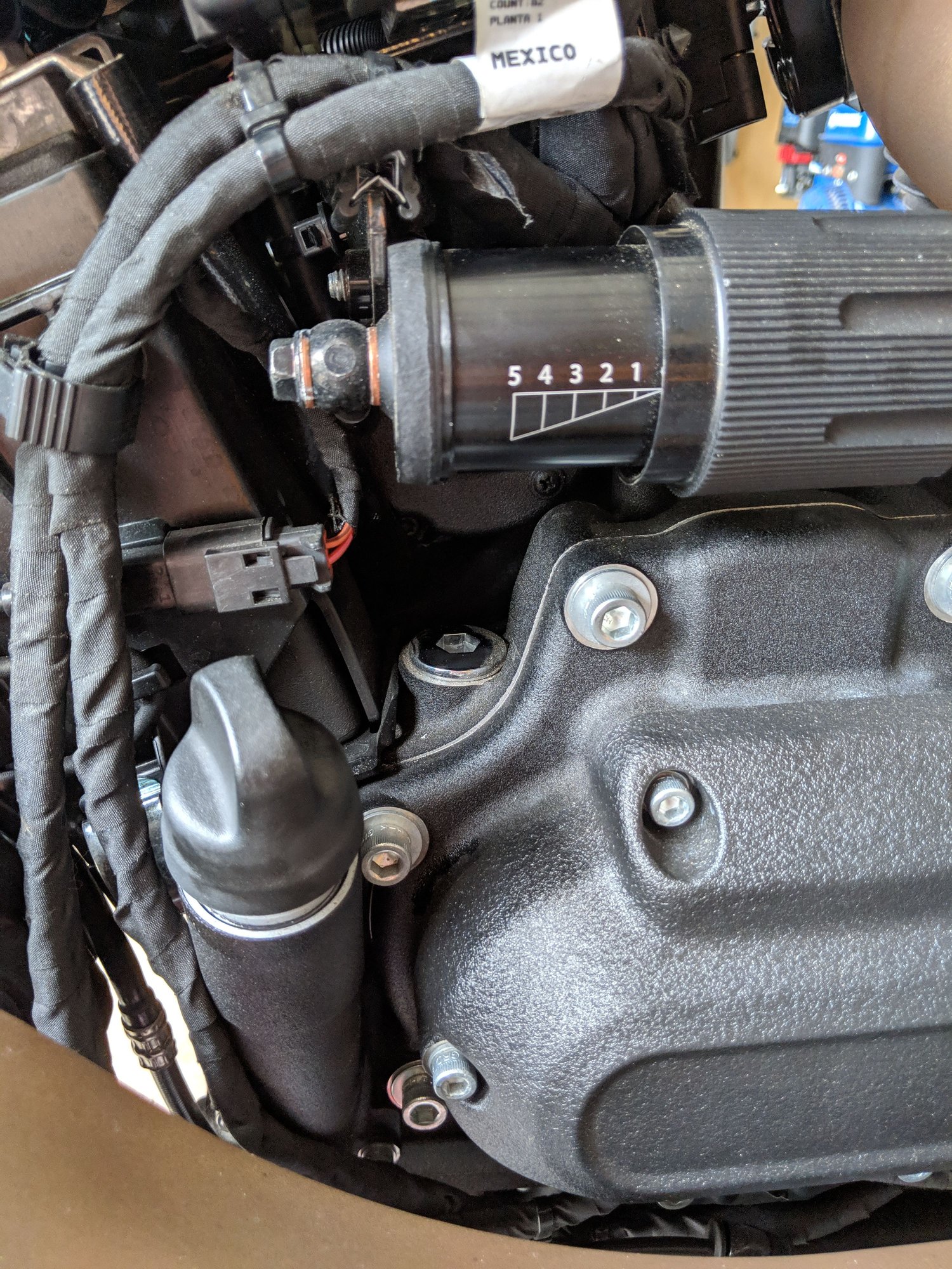

How the heck do you check/fill the transmission in these?
The dip stick is so far in there. Is there a trick I'm missing?
Thanks.

I figured it out... What a pain in the ***.

Dan D, did you al so noticed that the bike has plenty of Mexico stickers on it, almost every electric cable has one.
Wiring must be cheaper in Mexico I think

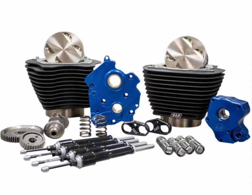

Just love this. I am getting similar comments too, even on the standard tyres my 114 turns in and catapults out of the corner. I am just about to fit V&H slip ons, and will eventually work up to a Stage 4 - also like the look of this S&S 124 MegaBob kit
