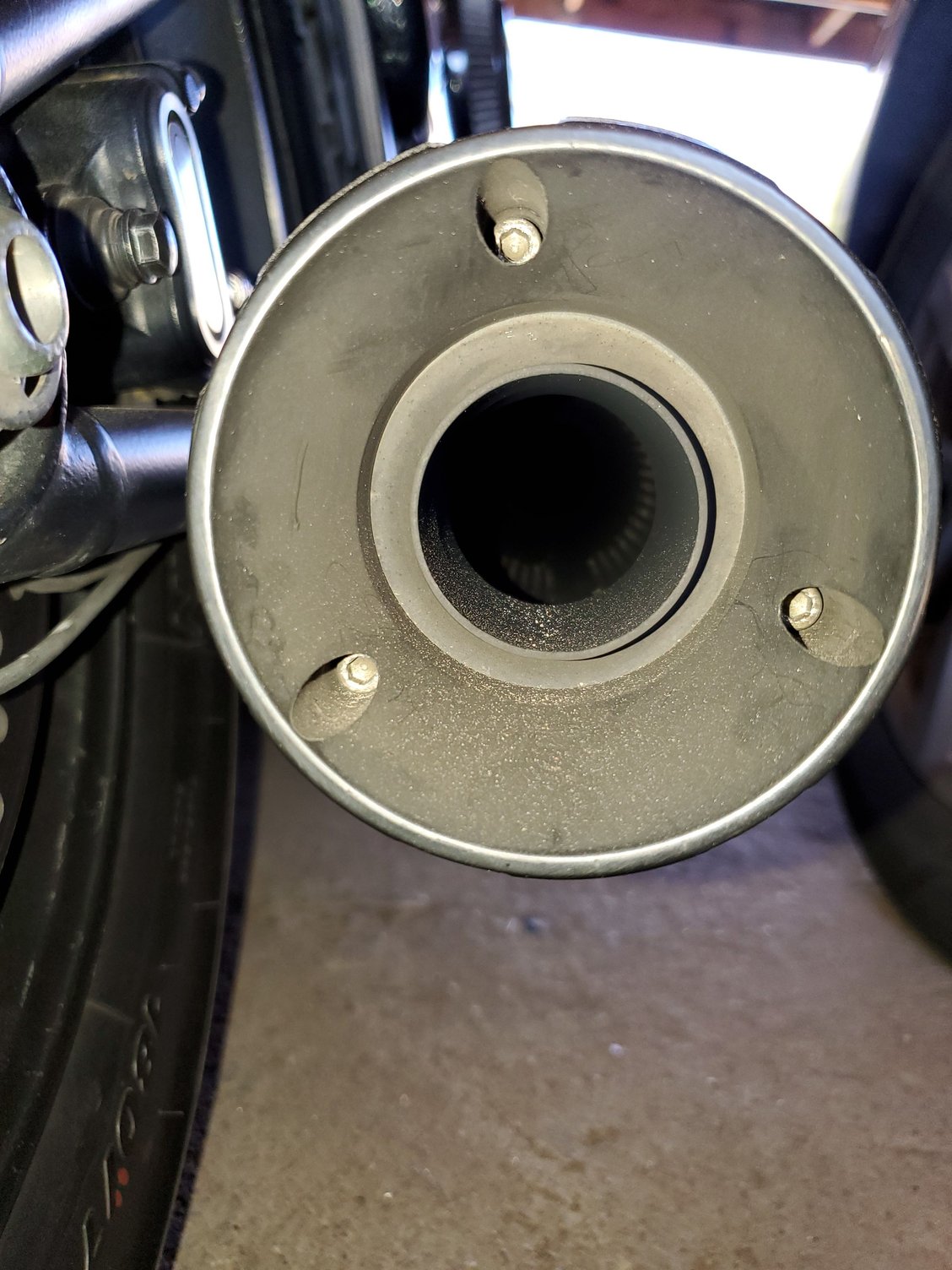

How did you remove the dB reducer? I was able to remove 2 hex-head bolts from the end cap at 5:00 and 7:00 with an Allen wrench but couldn’t remove the one at 12:00. What tool removes that one?

The same tool that removes the other 2. A regular old hex key. If you have the EPA compliant version of the pipe then I've seen a special tool is needed because they have the tamper proof bolts with a little post that prevents regular allens from being inserted.
The race version with no cat in the muffler has regular hex head bolts that don't require a speical tool. Not sure what version you have but I had no issues removing the bolts to get to the dB reducer.

It's a special 7 point security bit, hard to find.
Some have used a regular security bit and modified or hammered it in to remove the screw or check this link for some info.
https://www.hdforums.com/forum/2018-...l#post18452311

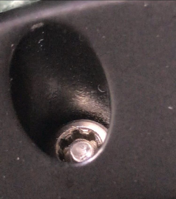

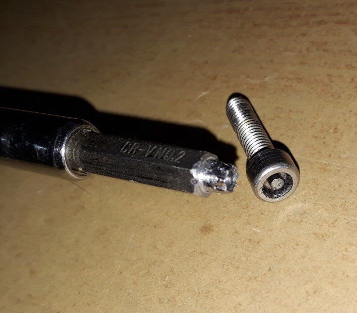

Originally Posted by 2020 Fat Bob
What tool removes the “tamper proof” bolt?
Like we are telling above, a special torxbit that as far I know you can not buy. I made one myself and afterwords I changed the bolt with regular security tox bolts.
The S&S torx bolt
The torxbit I made myself
