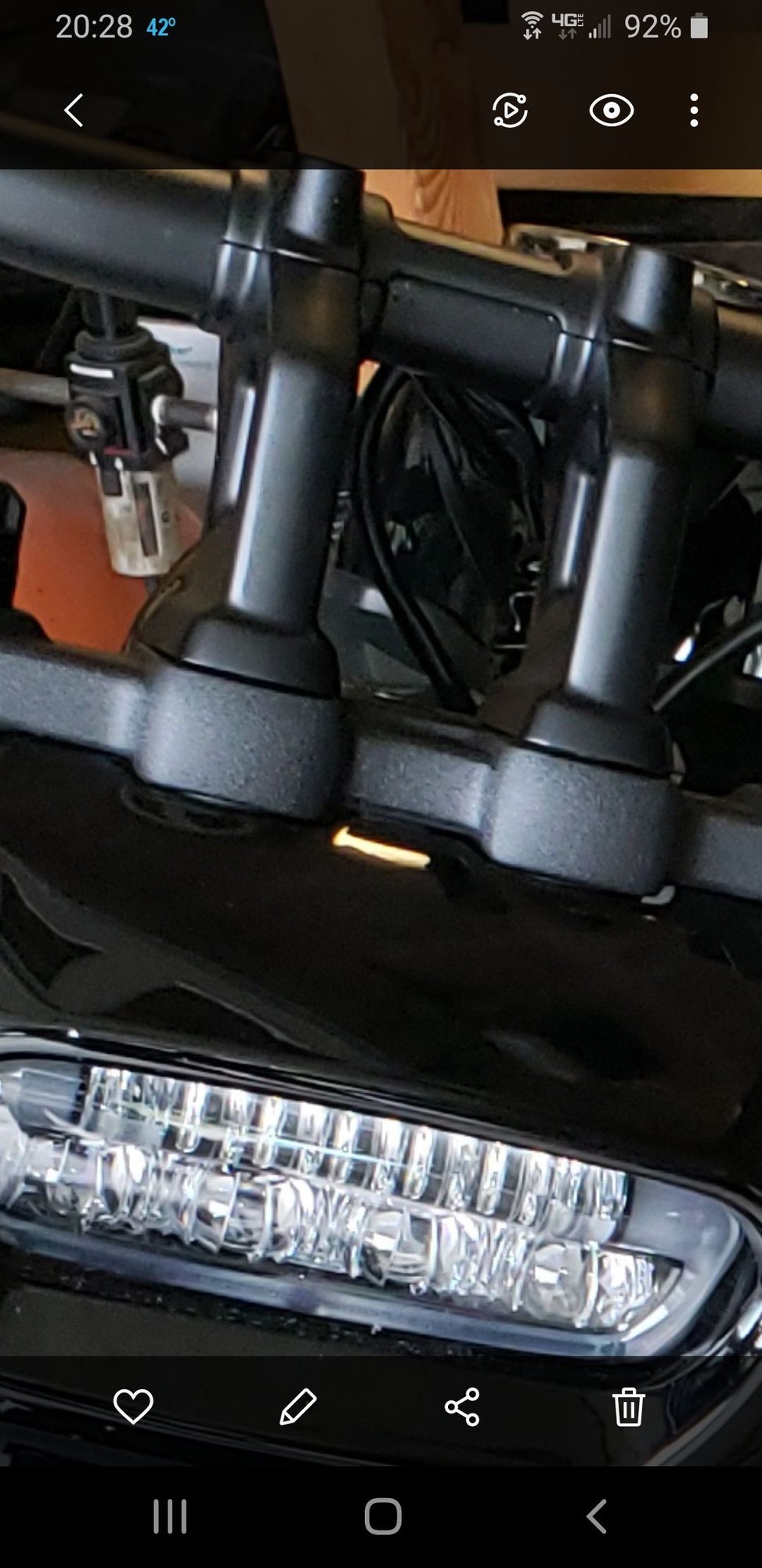

I just installed the 3 in CJ Motorsport risers on my 2018 FXFBS with ABS. I was able to use all stock lines.
I see in your pictures there is a gap where the risers connect. There should be no gap. I purchased mine used from a forum member so I had no mounting instructions. When he sent them he mentioned it took him a few tries to get them mounted correctly. He also sent me a few pictures as well. When looking at his pictures he also had a gap. These are not installed correctly. In order to install correctly you need to take the rubber bumpers off the OEM risers and install them on the CJ risers. The hard metal round disk that create the gap should fit snugly into the space you removed the rubber bumpers from. This will create flush connection. Your risers are upside down.
First picture is from the guy I purchased from. You can clearly see the gap. Second picture is how I installed them.
I could be wrong but it looks like you have a similar gap as the first picture.
I tried both ways when installing and currently have them installed as you describe and gap is present. The only way I could achieve no gap was to remove the metal washer from rubber isolator on top of triple tree.
Did you install with original metal washer on top?
CJM website shows all original washers and rubber installed with there bolt and an additional washer on bottom.
I think there is supposed to be a small gap so that the rubber can insulate the riser and handlebar from vibration through the triple tree. If riser is hard mounted to triple tree it effectively eliminates any dampening from the rubber isolaters.
I have a pic of my riser from before with a small gap. Also including pic from CJM website.
I dont mean any disrespect to you by responding, and I appreciate you backing me up on the install. I am always willing to consider all options.
Zoom in and you can see a little gap
Tried to get a pic here, you can see the original metal washer. I transplanted the rubber stoppers to the bottom of the CJM piece as well (no effect on gap).

I used all of the OEM parts metal washers on top and bottom. I don’t know what CJM instructions are for mounting as I did not buy them new. I tried to mock them up with the round metal disk sitting on the triple tree but did not believe they are designed to rest on two small points like that. I did pull the 4 rubber pieces from the OEM risers and installed them into the CJM risers. This all provided a snug fit with no gap. I’m no engineer but this seemed to be the most logical way to install. I did not have any gap on the stock set up as you do. Maybe some else can chime in about that. I guess someone could call CJM to get a clear answer. Seems the mounting instructions would be a bit more specific. 🤷🏼‍♂️
