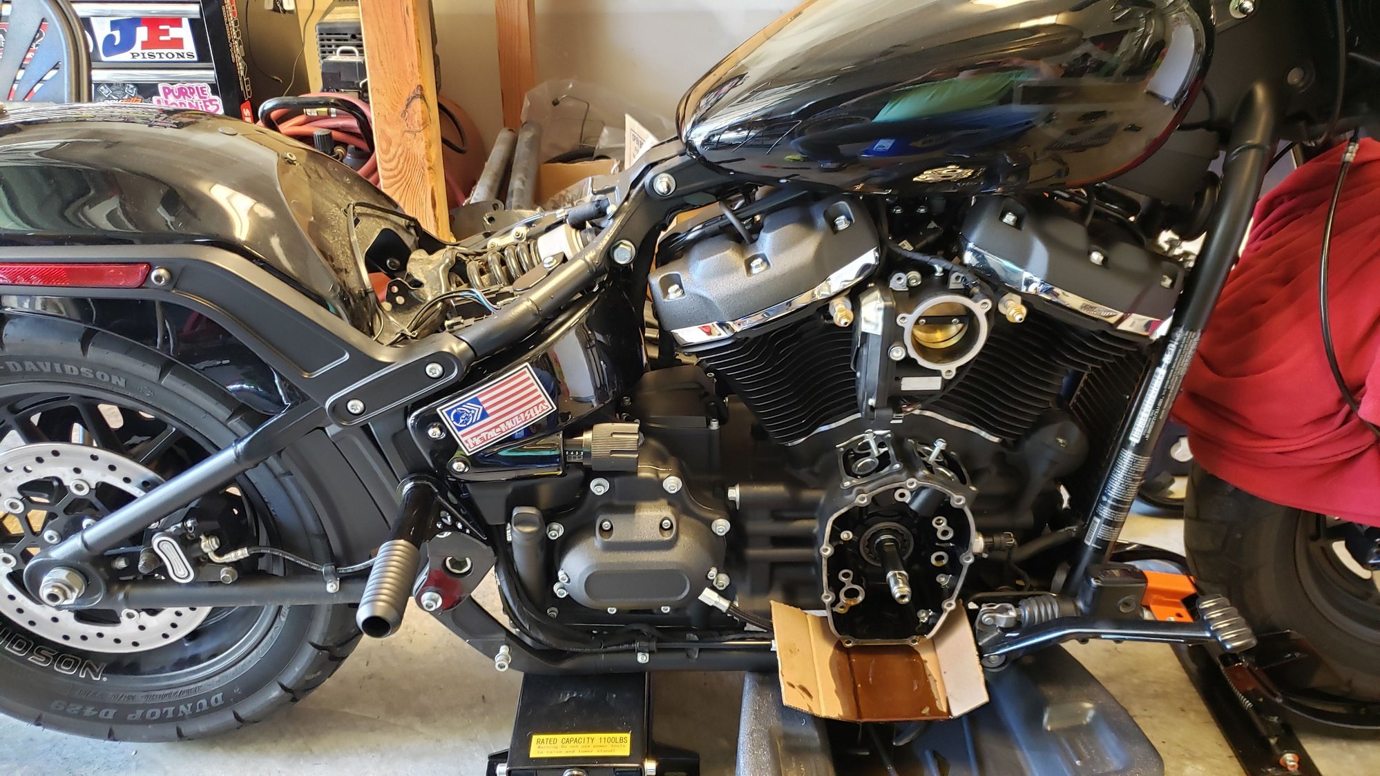

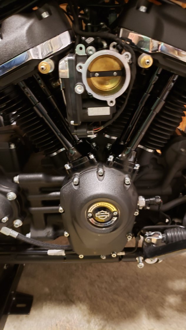

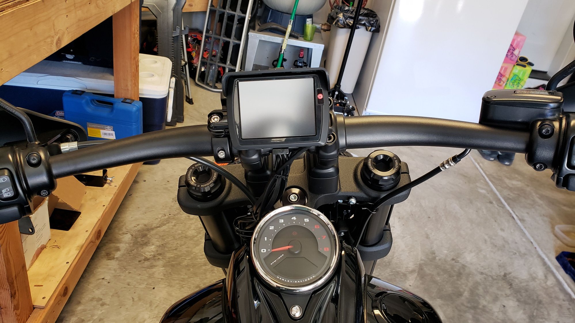

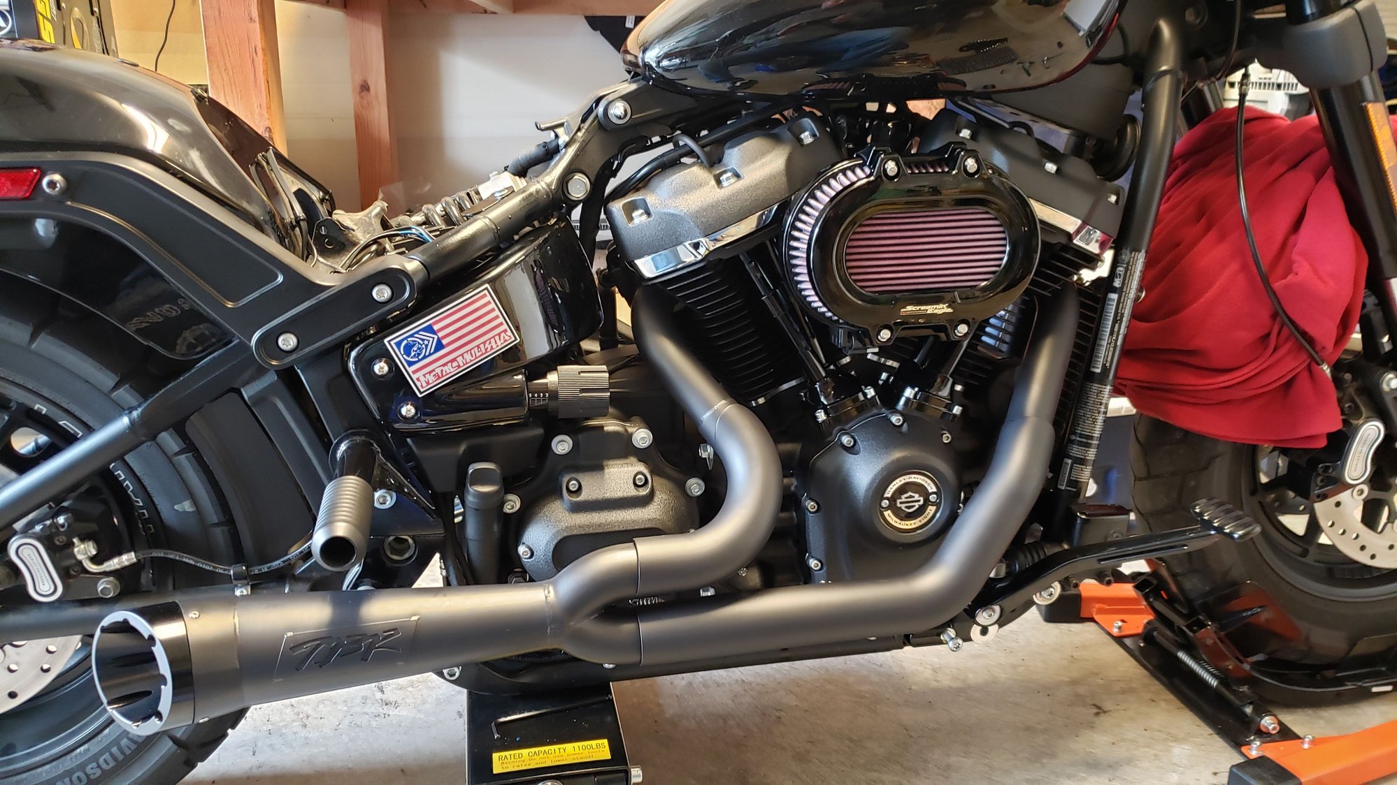

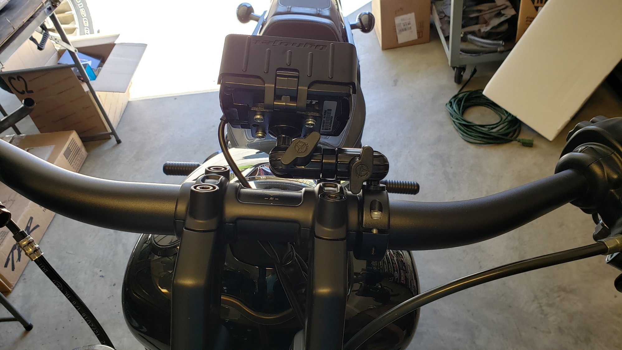

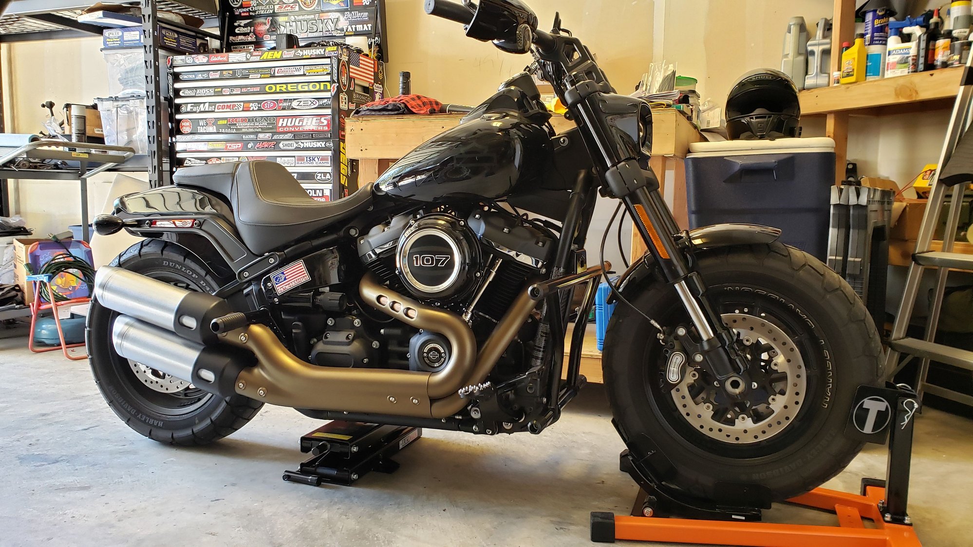

After 9000 miles in its first year, I decided to go ahead and add some power and sound to my Fat Bob. I went with the SE Extreme Ventilator, TBR Shorty Turnout, S&S 475C Cam, and a Powervision with tune from Fuel Moto. Did the install last night on the cam chest and put the bike back together this morning. First impressions are:
1) It is loud.
2) It is lopey.
3) It rips.
I wish I would have done this sooner. Test ride went great and the butt dyno says it is a major improvement. It was like a whole new bike, really woke her up. Broke the tires loose a couple times and had a blast. I think I watched all of the videos of exhaust sound clips on the internet and they never seem to do justice to actual sound. TBR turnout is loud with a great deep rumble at idle, and screams at higher RPM's. Running 6th on highway didn't seem to bad but I would new more seat time to know if it is going to annoy me or not.
Overall the install is pretty basic. I did switch out the lifter covers and pushrod tubes to black. I think I spent the most amount of time on those hard to get to socket head screws on the lifter covers. I did use the HD black tubes and paired them with the Fuel Moto Quickee Pushrods that can be used with the HD pushrod tubes (adjuster is lower on the pushrod). Found a eBay version of Jim's bearing tool for 100 bucks vice ~250 and it worked as described. Also used a twin cam sprocket lock that fit between the cam gears just fine.
Here are some pics before/during/after:
Edit to add photos of PV mounted with Tackform clamp and arm.

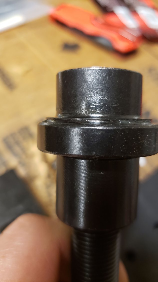

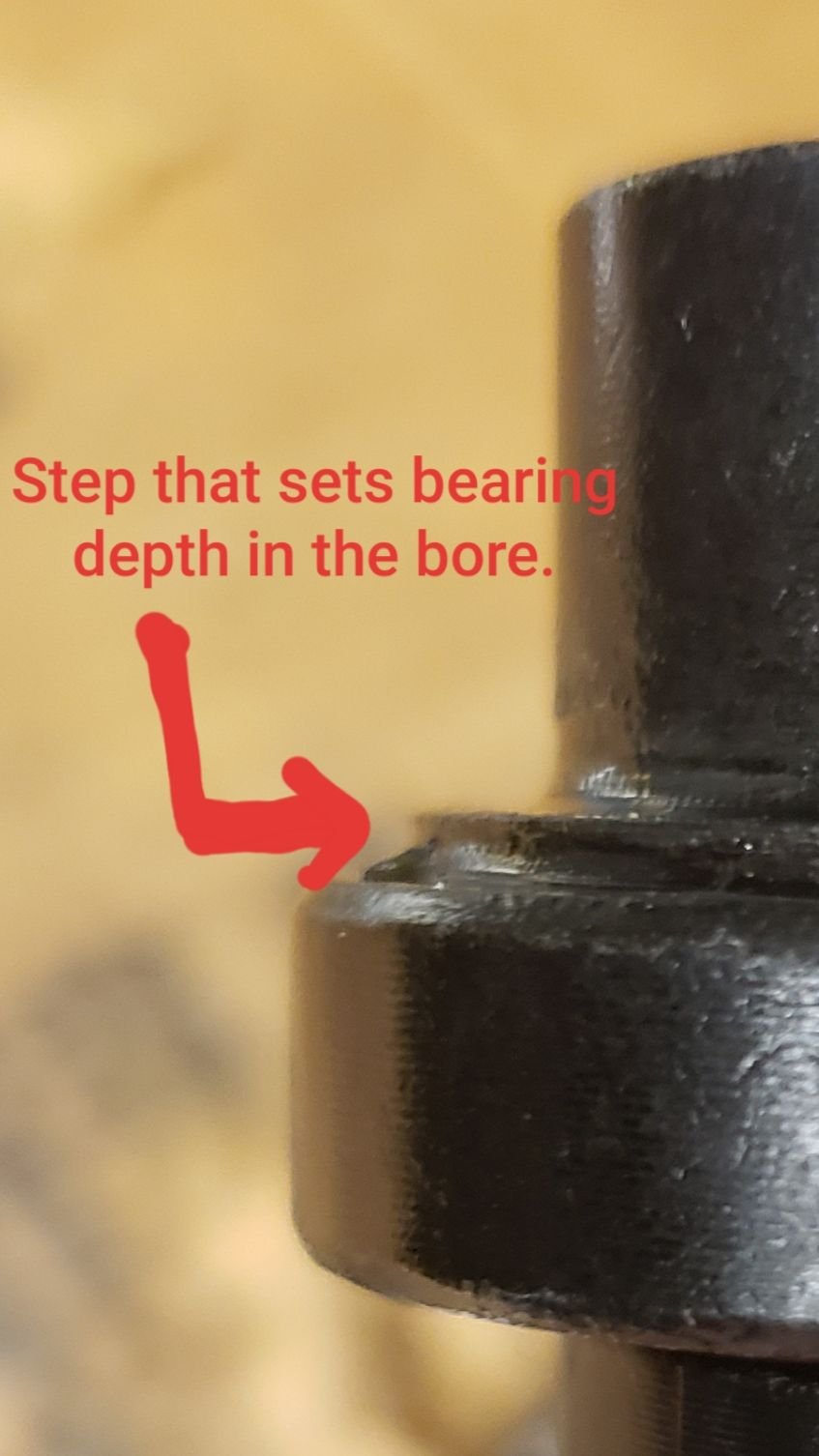

Originally Posted by Bowhunter8607
You reporting the tool working fine makes me a bit less hesitant about getting one. I appreciate it. One question I have is, was it difficult to press the cam bearing in within spec using this tool?
I was concerned about this as well, as it is one of the only critical steps of the procedure. The tool takes the worry out of it though. The tool head that holds the bearing for install is stepped which allows the bearing to be pressed in only the specified amount. I wish I had taken more pics of the bearing depth on the bike but I did not. Here is a close up of the tool head so you can see the step. Hope this helps.
Here is a link to the tool I bought off ebay:
https://www.ebay.com/itm/Harley-Davi...kAAOSw0vdeBR0s
