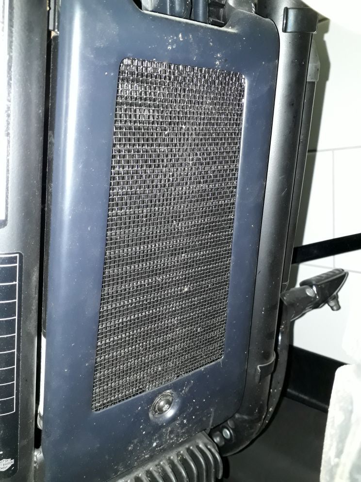

Does anyone know if there is an oil cooler cover & or radiator cover out there for the Fat Bob? Kuryakyn has one but looks too much like an hvac vent.
I haven't looked for one but I plan on doing what many here have done and just adding some mesh to the inside of the oil cooler "frame" or whatever it's called with some double sided trim tape. Seems to do the job, looks decent and is inexpensive to do.

Was one of the first mods I did, is a black RVS mesh.

Yeah....definitely do it. It's cheap and saves your oil cooler from stones. If you looked at my voltage regulator and oil cooler surround after 20K miles, you'd see the issue.
I bashed out the dents in the oil cooler surround and painted it, then hit the voltage regulator with some wrinkle black paint. Looks better than new now.

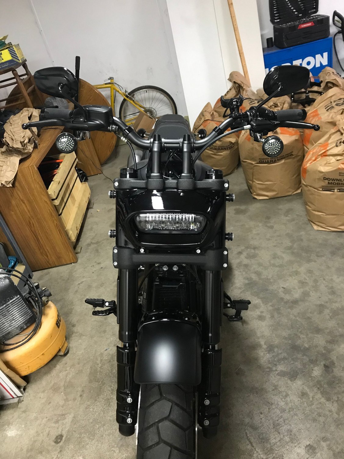

Cleaning it up. Bing King relocate and LED’s.

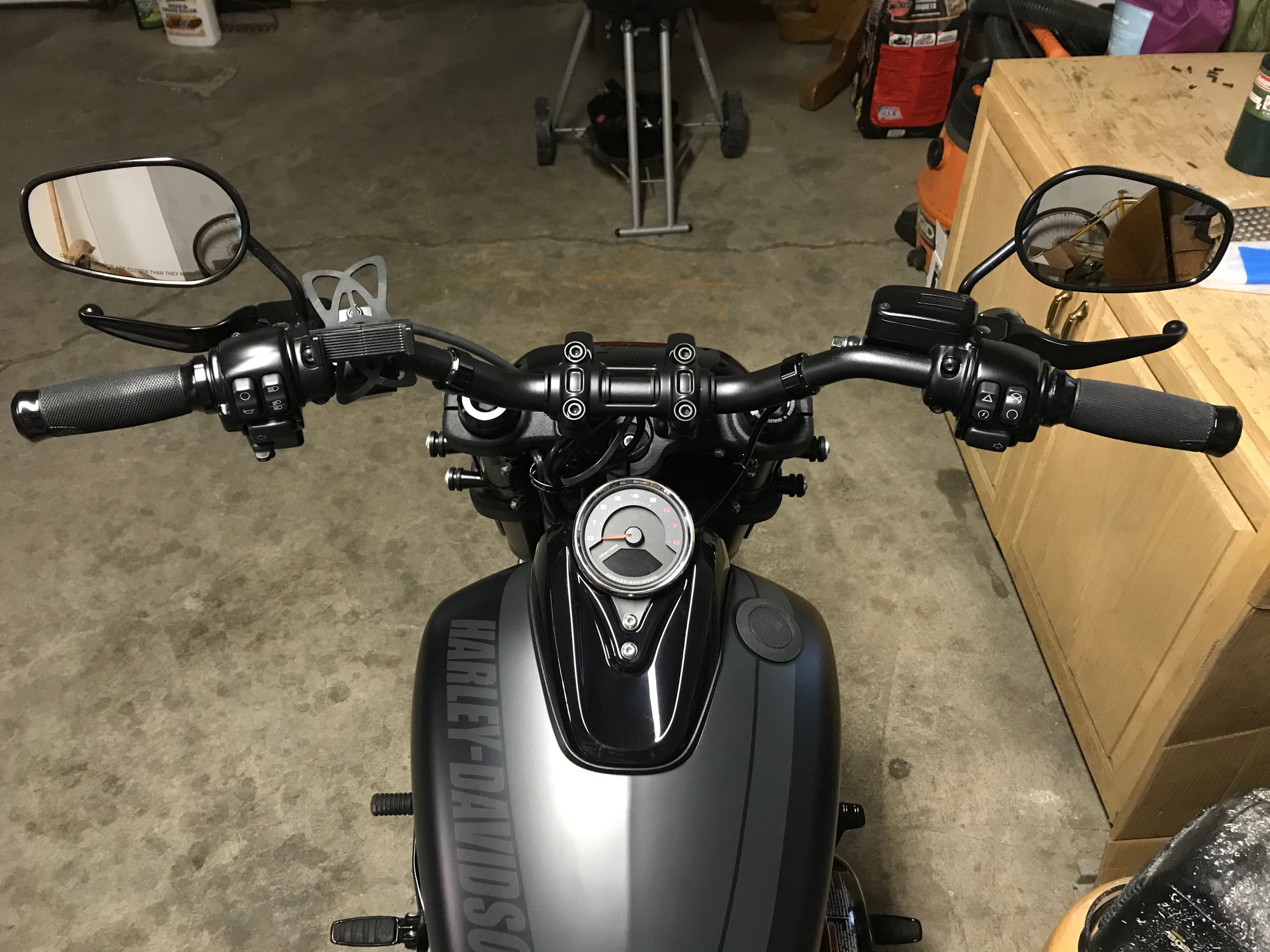

Installed RSD 4” Prostep bars, black anodized riser bolts, grips, black levers and LED turn signals. The bars are originally made for cable, but I thought they would look great on the bob so a 21mm reamer and a couple hours of work was necessary. No cables or wires needed (thankfully)!
