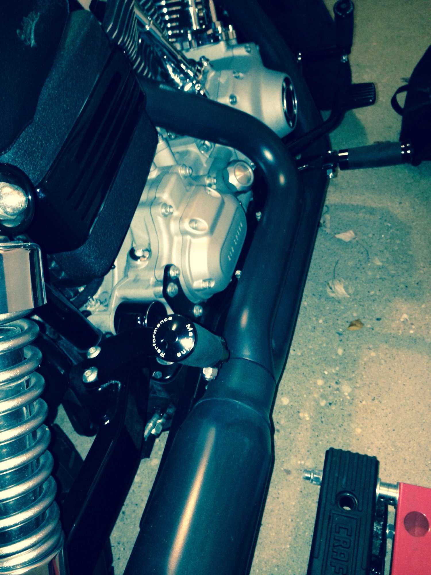

Got a question for anybody that has installed Fat Cats before:
While installing the header piece, I got the 2 flanges over the cylinder studs and hand tightened the 4 exhaust nuts but it seemed like the headers were not sliding into the cylinder exhaust ports very far. So I just thought that they would slide in all the way once I started to tighten down the exhaust nuts, but I just felt like the torque pressure was getting too high for not having the headers fully seated.
Anybody else have this issue? I know that nothing was cross threaded. Here is a pic of where the front header was when the torque seemed too high to continue:

Went out and took a pic of my front. Looks about the same as yours ?

From: Anoka,MN
Sorry for the blurry pic. Looks like my flange is seated closer to the pipe collar. Mine are torqued to 115 in/lbs
