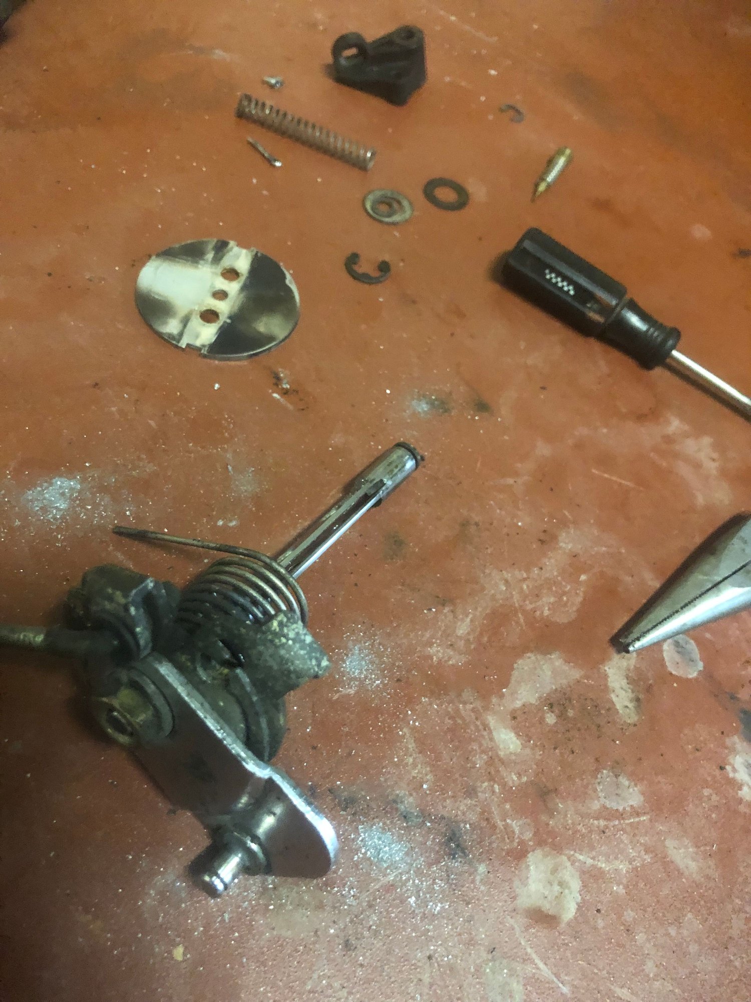

I did get this extracted from my cruise control carb and I have found others saying the 44mm plate can fit this shaft on a noncruise cv44 with a little filing.

Of you can find the 44 mm go with that. A 51 is going to be way too big for that build. I don't think you'll get any benefit out of it, so instead of trying to find something that ain't there go with the 44.....
