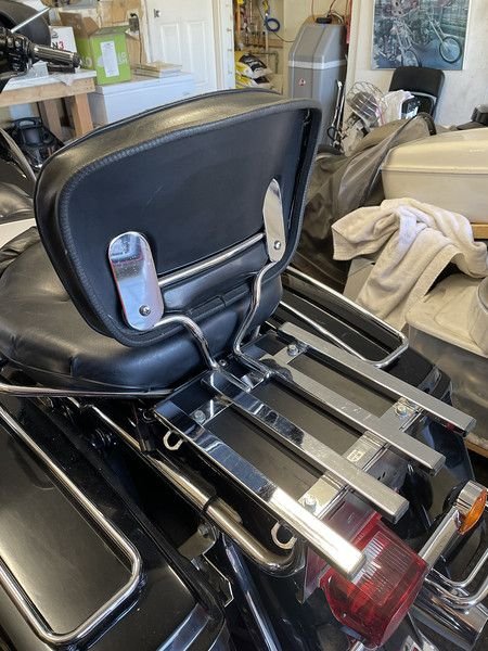

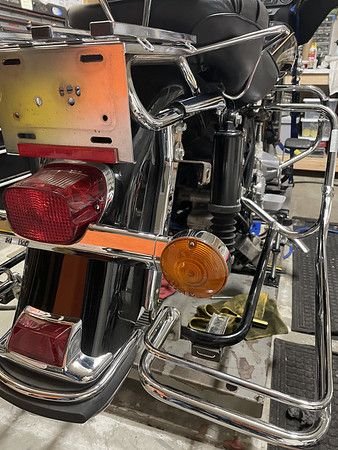

So on the plus side the passenger backrest and luggage rack is mounted
And on the flip side, day n+1...

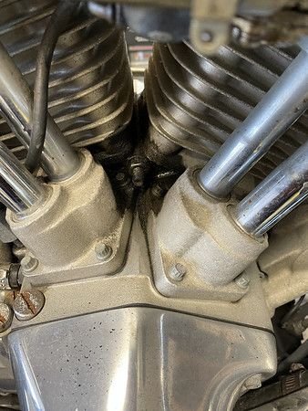

...not going to be on the road as quickly as I had hoped for. Top end needed due to leaks on cylinder base gaskets.
Need to pull the primary components to determine the source of the leak. Maybe the oil seal on the inner primary that holds the mainshaft?

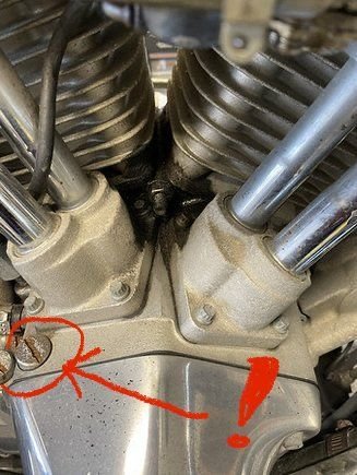

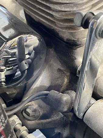

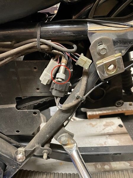

Is this the antenna connection for the radio? Found this when I pulled the left cover. (Still have to determine why the radio does not work tho.) How do I mount an antenna without the tour-pak? What/where do I get the proper one?

The Evo engine has a mesh tappet oil screen, which you should remove and clean every oil change.
(Personally I have never detected any dirt stucked in the screen, so nowadays I check and clean every third time I change the oil fluids).
You'll need a tool called "drag link socket" to remove the tappet oil screen cover bolt.
The cover bolt metal is very soft, so you will possibly damage it if you don't use the right tool.
Also, the bottom grove is not flat.
Look carefully and You will see that it gets deeper towards the middle so the drag link socket should be modyfied accordingly.
I can see som slight damage to that bolt on your bike.
It can be a PITA to get that bolt out if it is damaged to badly.

Thank you. I have that on my list as well but forgot to mention it. I have the corrects drag link to remove all three plugs. I am going to replace them with plugs that use an allen wrench.

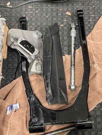

rizzo... the only reason I am not inclined to do so is the very low milage on the bike.

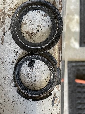

That said I will replace the outer nylon seals. Should have them on Friday.

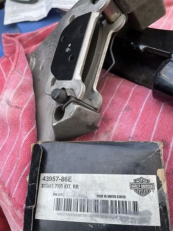

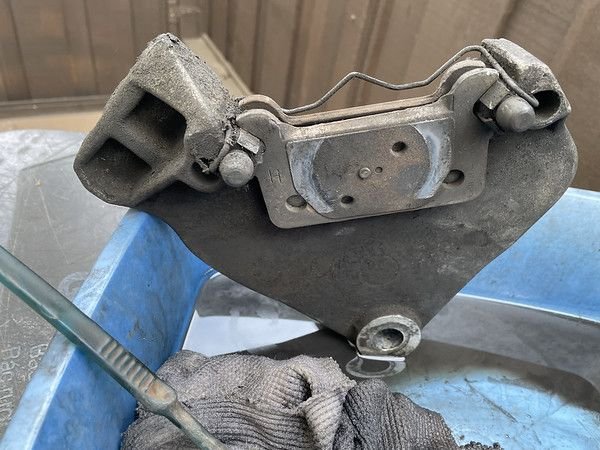

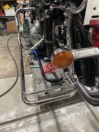

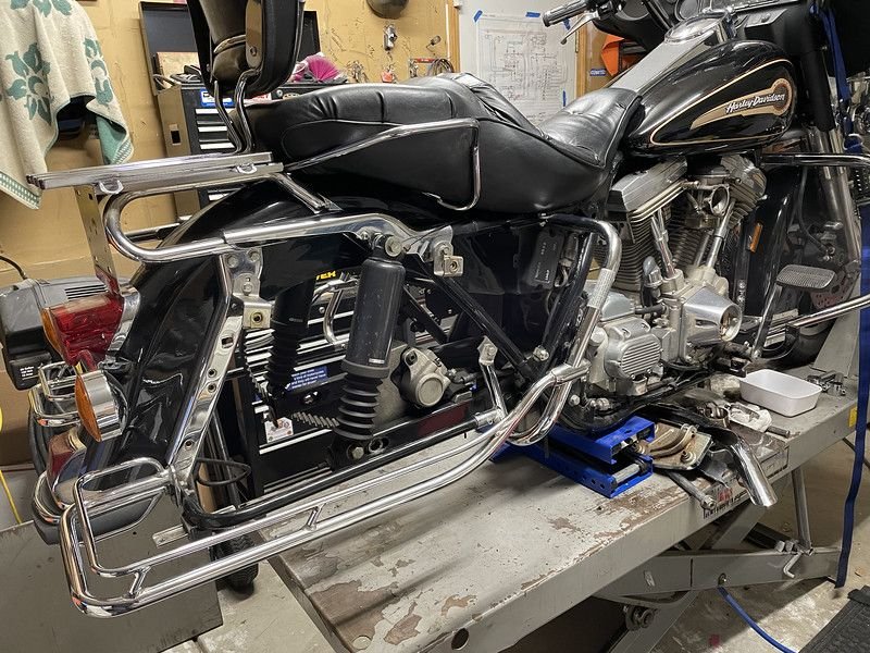

This afternoon was spent cleaning the rear fork, back end (lower section below the fender rails), & replacing brake pads (caliper work comes tomorrow). Hard to tell from the "after-cleaning" pics but there was a lot of "crud" on the rear end along with a lot of surface rust on the chrome parts.

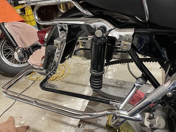

And of course I must include my "Rookie" mistake. I pulled the rear fork and absolutey forgot about the rubber mounted motor. Hey...it's my first, what can I say. I was celaning stuff and noticed that the parts were not aligned and then realized that I did not support the ***-end of the motor/tranny when I pulled the fork.
The jack I have had since the 80s. Think I got it from an advertizement in one of my EaryRider mags. Has always been a part of my tool kits on long rides (over the Rockies).. Have the jack in place and should be able to keep it in place and adjsut as needed in order to instal the axle.
