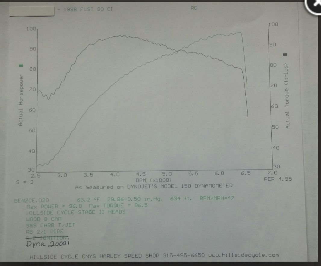

A Woods 8 @10.87:1 with stage II heads and that S&S E will get both hp/tq in the low to mid 90's..
lol 10.87:1 is kinda an odd number? Is that from a program that lets you bump compression just until it shows it’s sweet spot? Or did you run that cc’d mechanical compression and know it cranked?

It's what I ended up with for my build based on all my parts. But still it's driven by the camshaft and the minimum for that cam is 10.7:1 static..
