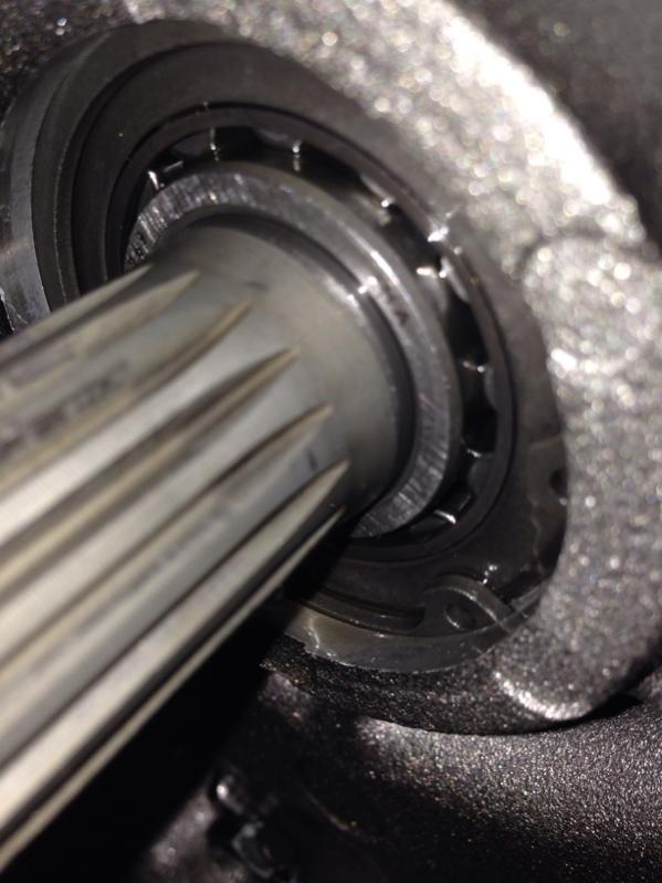

Old Jun 22, 2014 | 01:54 PM
  #184
br549A1's Avatar
br549A1
Joined: Nov 2013
Posts: 2,358
Likes: 34
Here's a pic of both. I can't see any wear on either. I think the 98 basket can be disassembled without the clutch tool. I don't know if it's worth taking it apart. I guess if the comp doesn't solve the problem it's all gotta come back apart and I could change the clutch bearing then. It's apart until Friday so I have time of needed

Old Jun 22, 2014 | 03:31 PM
  #186
Spanners39's Avatar
Spanners39
Joined: Dec 2010
Posts: 7,736
Likes: 1,524
From: Coromandel Peninsula New Zealand
It can be disassembled without the tool, your splines are fine but it looks like your Inner Primary Race has walked out towards the clutch and that in itself will cause vibes because the rollers hang off the edge of the race slightly.
When I put the S&S inner race on my TC it reduced the vibes dramatically as mine had walked the other way..
Can you get an in-focus version of pic number 2 please?
Old Jun 22, 2014 | 04:19 PM
  #187
br549A1's Avatar
br549A1
Joined: Nov 2013
Posts: 2,358
Likes: 34
Heres a few, hard to get a clear one
Attached Thumbnails Evo shake-image-3841284608.jpg   Evo shake-image-3782153636.jpg   Evo shake-image-1849646693.jpg   Evo shake-image-2235833484.jpg
Old Jun 22, 2014 | 04:45 PM
  #188
Spanners39's Avatar
Spanners39
Joined: Dec 2010
Posts: 7,736
Likes: 1,524
I would say it has walked and there is very little margin for error so best to sort it.
Old Jun 22, 2014 | 04:53 PM
  #189
br549A1's Avatar
br549A1
Joined: Nov 2013
Posts: 2,358
Likes: 34
it's not just wide? Damn. Didn't even think it looked like it wasn't fine
Old Jun 22, 2014 | 05:47 PM
  #190
br549A1's Avatar
br549A1
Joined: Nov 2013
Posts: 2,358
Likes: 34
Trying to look up the race that's on it and the numbers don't match. It's stamped INA USA but I can't locate it. It doesn't match the part numbers listed f067769. The 0 could be a c or o.
Also. Doesn't the clutch hub go flush to the race keeping it from walking outwards? I thought they could only walk in towards the seal?
