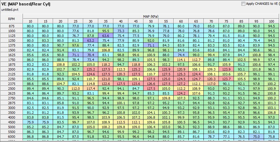

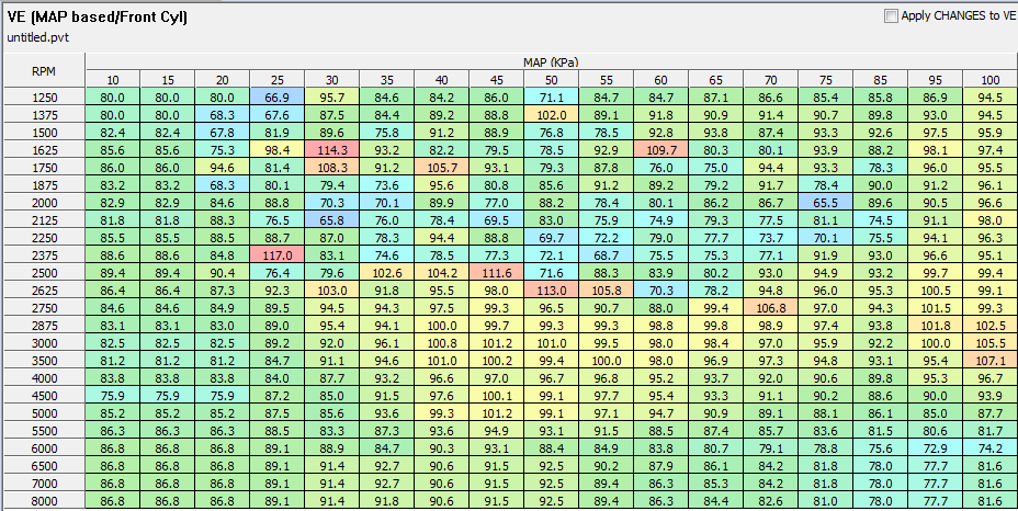

I really hope they aren't switched. I'm going to be pretty mad if it came from the factory like this. Here are my VE tables
Front:
Rear:
Would not be the first bike delivered with the 02 sensors in the wrong spots but seeing your mods, it probably didn't come from the factory that way. Pop your side cover off and follow the wires to the sensor. Black plug goes to the back cylinder.
