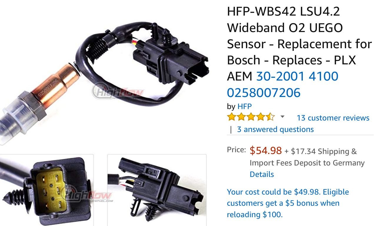

Have a 2001 softail which is now a 103, dynojet Dyno tuned with which I use a PV / Auotune. The bike is nicely locked in so the Sensors, wiring, auotune box, cables and PV live in a box until I need to fiddle eg I recently went from a Propipe to a Supertrapp setup.
thing is, I also have a 2010 Glide which is getting similar engine treatment. It will of course be tuned on the same Dyno. However, with the later ECU I can use the Target Tune which I bought as an upgrade having already the sensors and cables from the autotune. In this case, the PV will always be on the handlebars and the sensor / Target Tune setup permanently wired in.
To play with the softail again I don’t want to go to the trouble of removing the sensors and wires from the glide every time. I can buy a second Y connector, sensors and their cables from Dynojet but the prices (except for the Y connector) are silly. The Bosch sensors with correct connector and “free air” calibration plus the female connector cables are available for less than half the Dynojet price.
Do we know if there is something extra different in the sensors Dynojet use (obviously correct calibration is critical here)? Or is there anything else to take into consideration?
Would rather buy from Dynojet as they did all the work in bringing us these wonderful products but the price difference has to have a logical limit.
the PV has a quick release mount, I have a second cable so the PV wiring is in place on both bikes and of course there is a license for each bike on thePV
The wideband sensors used with all of the Dynojet Auto Tune kits, Target Tune, and Dynoware RT is Bosch part # 17205

Appears to be exact same - Bosch part Number not even similar though
cheers Jamie that is great info - so not this one?
