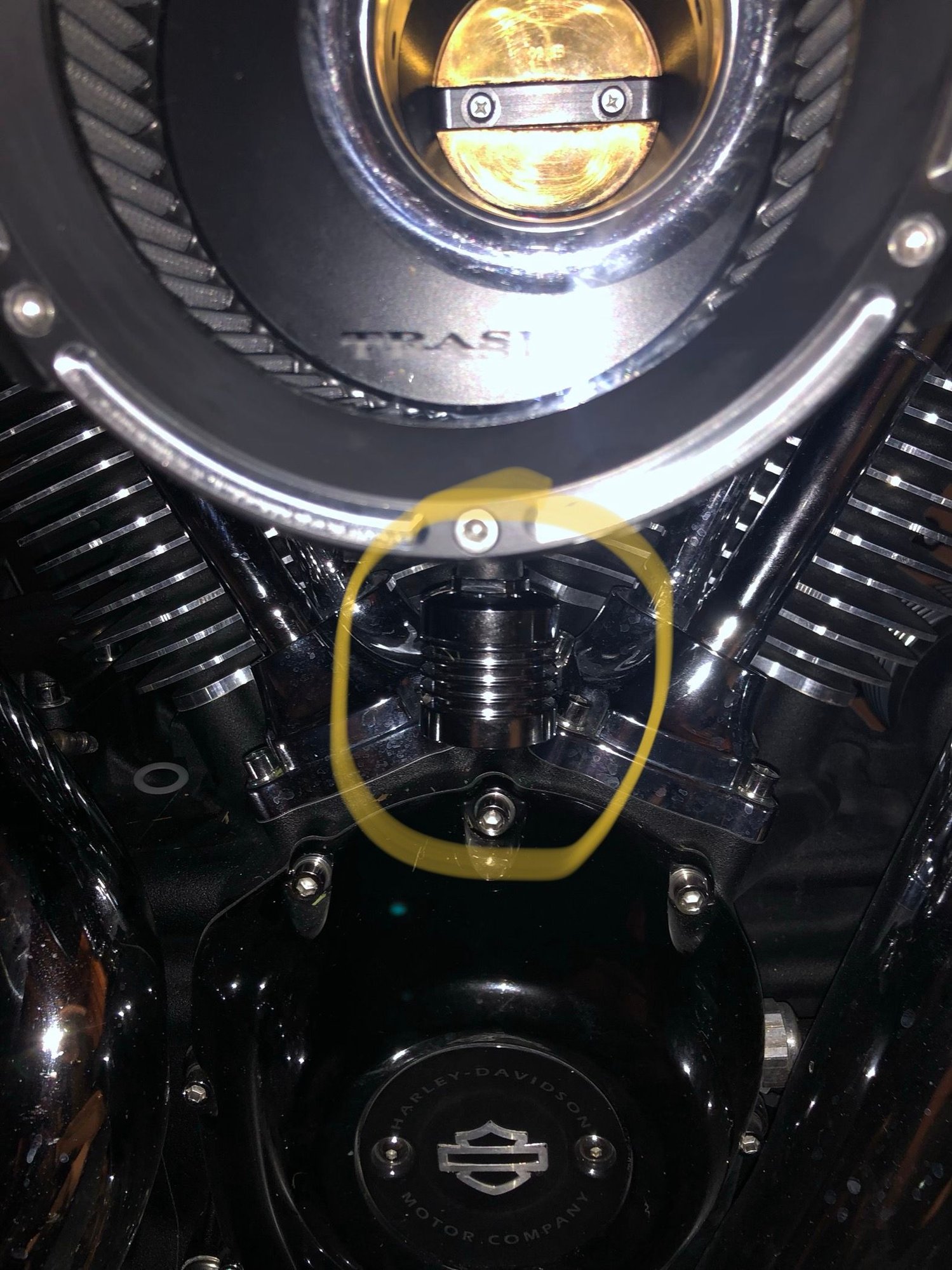

Originally Posted by yobtaf103
Like the bike Doc, going to be interesting to see how this goes ,thanks for sharing
Does the Trask come stock vented or you modding it?
Noticed when FM done their cam testing nearly all charts shown a dip in the torque curve, they followed up with a higher flow AC (than the SE stg 1) which eradicated the dip
Good intake seems also key to me with the M8, after all T-man selling the "no loss*AC $650 a pop!
Isn't it advised to use new head bolts/cam drive bolts, see T-man offers a tighter tolerance crank/cam drive sprocket, if yours is slack fit one.
I had to mod the crap out of things, used banjo fittings, jb weld, drilling, shims, etc., but it works pretty flawlessly and I think looks good. I can take more pics if you like once I get the bike back. As far as the head and cam bolts, you are speaking Greek to me lol. I don’t know if they are needed or not, but I’m sure my dealership is more than happy to point out anything they can charge me money for hahaha.
