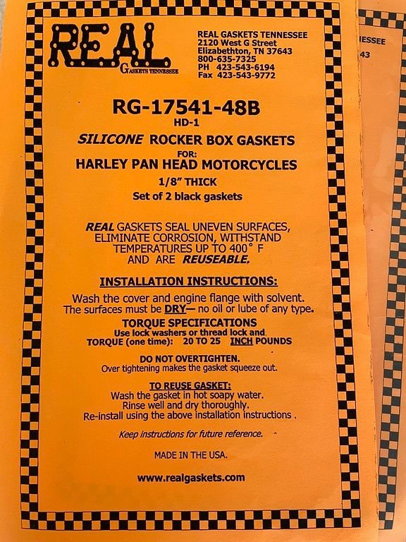

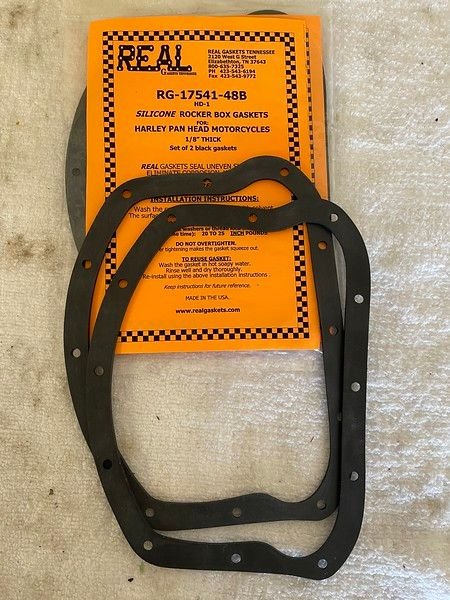

Anyone try these rocker cover gaskets?

I used paper on my 48 and cometic on my 54, neither leak

The paper will the cometic wont - we tried this forever with leaks till cometic every glue known to man we used to no avail
it will slither between the paper and not the glue - liberals are the same way
