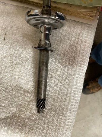

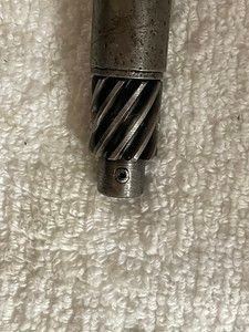

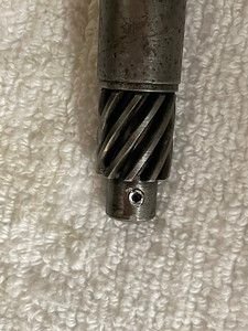

Best way to remove the the roll pin on the timer shaft so that I can get the gear off and have the body de-chromed? I'm assuming drill (have a drill press). If so what is the proper size bit (don't want to muck things up with too large of a drill bit and ruin the shaft).

A roll pin punch? Strait pin punch will work in a bind..
Quality set of both are worth gold for precision work.

Punch is best, just don't use one so small it fits the inside diameter or it will expand the roll pin.
Never a drill.
