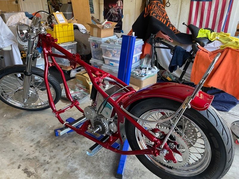

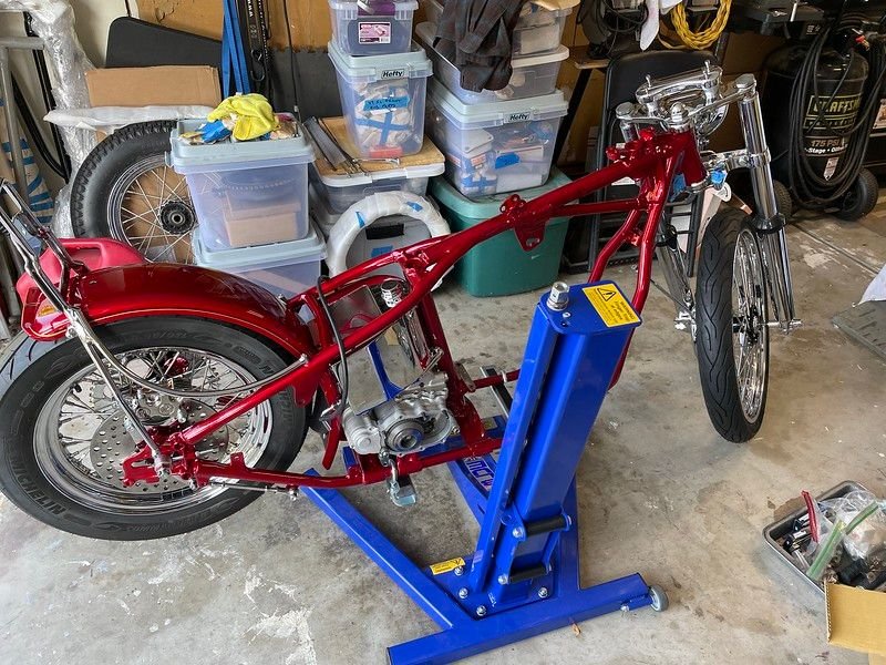

I haven't seen a bike lift like that. Pretty slick! Which manufacturer? Good luck with the build.

It's called a big blue m/c lift. Not cheap, but it works really well so far. Nice that it has such a small footprint.
http://bigbluemotorcyclelift.com/big-blue/

I'd forgotten the time it takes to prep a painted frame to get it ready to add parts back on. Cleaning surfaces for engine and transmission, removing paint from holes where bolts go and the like. Then there are the chromed nuts and bolts to check to make sure the threaded parts are clean. And of course trying to make sure you don't screw up the paint while reassembling everything.
And of course, I forgot that I did not have the needed base gaskets. Awaiting the arrival of the James set so that I can get the cylinders back on.

Looks great!

Yeh that looks really good, fresh paint is a PITA.
