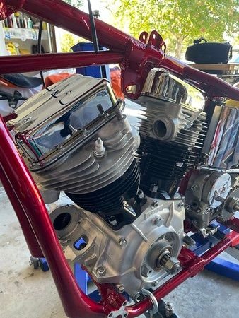

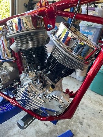

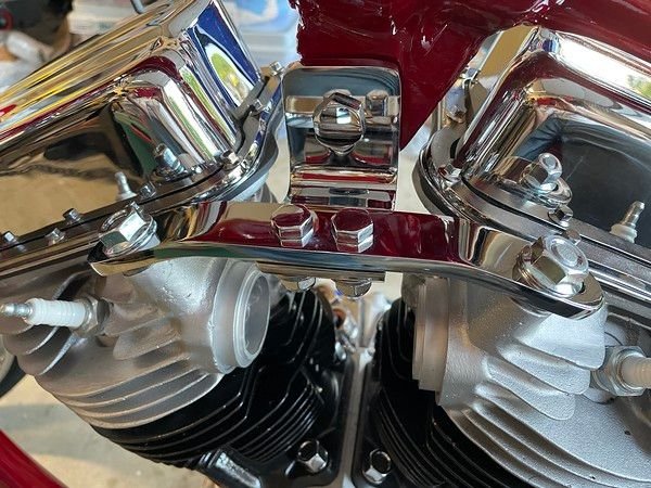

Well, the motor is back in the frame. Took a bit longer because I installed the heads after putting the bottom portion in. At age 76 I do not have the same strength I had when I was younger and had no intention of screwing up the paint cuz the clearance on the rear head is really really tight (so far only one small misstep). Used James cylinder base gaskets and Cometic head gaskets.
And the engine is not going anywhere (soon) with this motor mount.

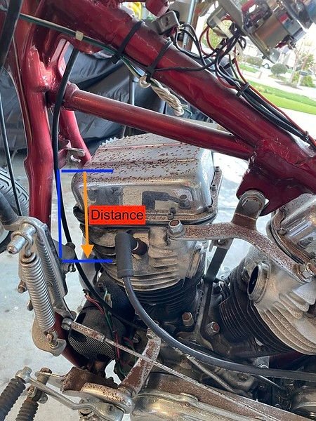

...and I need help locating the correct position for the mousetrap please. I have this diagram. Problem is that the centering point is take off the sidecar loops which are long since gone on the 50.
Thinking maybe some could give me some approximate measurements from the bottom of the tank mounts to the center of the u-bolt for attaching the mousetrap assembly. Not sure of any other way to configure it.
