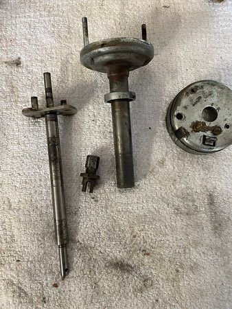

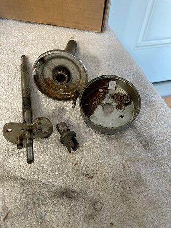

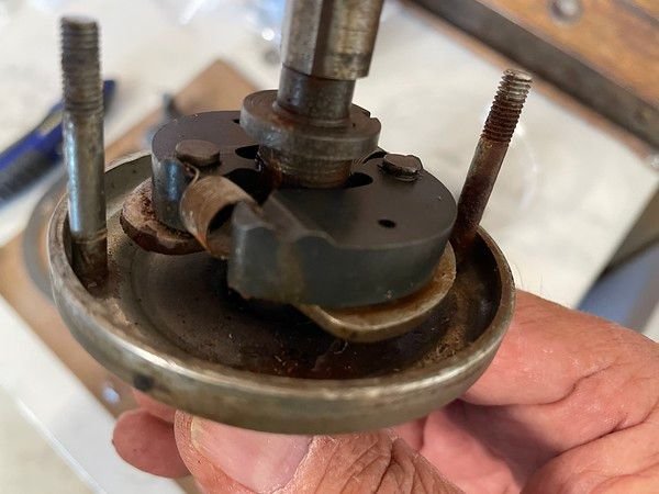

K, got the 66-69 auto advance, took it all apart but it will need refinishing
Cam has some obvious surface rust but I should be able to get most of it cleaned up well enough. The base plate, housing and shaft assembly will go out for new cad plating. There was no slop in the shaft and housing so the bushings are good to go. There was no excessive play on the gear end either. Weights "seem" fine and just a small amount of surface rust on the springs (tho I''ll most likely replace them).
Questions for the day...
1. How do I determine if the springs and weights need replacing?
2. What is the difference between the weights and springs used for 67-69 and 70-E78? Looking at them on the flea and they both look the same?
3. Have to remove the circuit breaker wire pin from the base. Noticed it is peened in place (my 49 uses one that is screwed int place). Peened stud vs screwed stud. Is that because the weights on the later style interferes with the earlier style stud used?

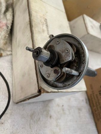

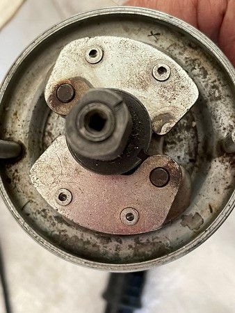

Well Hell's Bells, I kinda sorta answered question 3. Was digging thru my stash and opened a box I thought was an aftermarket electronic timer but found it was actually the 67-69 timer. (4th pic for comparison)
It is obvious that the spring and weight assembly is definitely NOT the same.
So Question 3.1...Can I use the weight / spring assembly the 4th pic? It definitely has less "moving" parts. Not against using the one from my stash but if I can use one with less parts I am all in for it. It's along haul from California to Florida if it needs fixing.
Old Nov 28, 2023 | 02:34 PM
  #227
johnjzjz's Avatar
johnjzjz
Posts: 12,878
Likes: 5,449
From: la la land jerzey
Left is the real one the right is the one we had used 20 plus years ago and the weights an springs will inter chasing with a 70 up advancer
