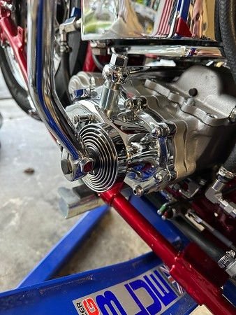

Well, been spending time on the 67 but decided to re-direct some attention on my niece's bike (now that I have the needed parts)
Got the kicker cover on and the kicker cover travels the requisite 180 degrees. The first attempt it only went 90 degrees because I had mis-aligned the ratchet gear on the shaft. Installations instructions were a bit vague (for me anyway).

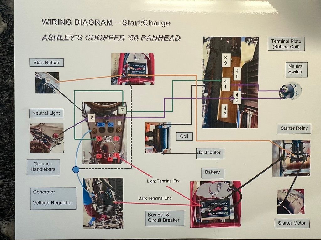

Electrical help request... Getting really close to a start up (haven't pressed the start button yet tho) Have the idiot lights one the dash, headlight (hi-low), tail light and break light. I wired in a neutral light built the wiring is wrong because the bulb blows. It's just a single wire, with a single filament bulb. The piece is an accessory light that was available back in the late40/early 50).
Anyone point me in the right direction?

Well thanks to Twizted Biker the mousetrap is in working condition (thank you Dan). For some reason I couldn't somehow get it right no matter what I did.
Ended up removing the accessory (neutral) light. A single wire type will not work. Found a two wire that I am going to try next (one to hot other to ground).
