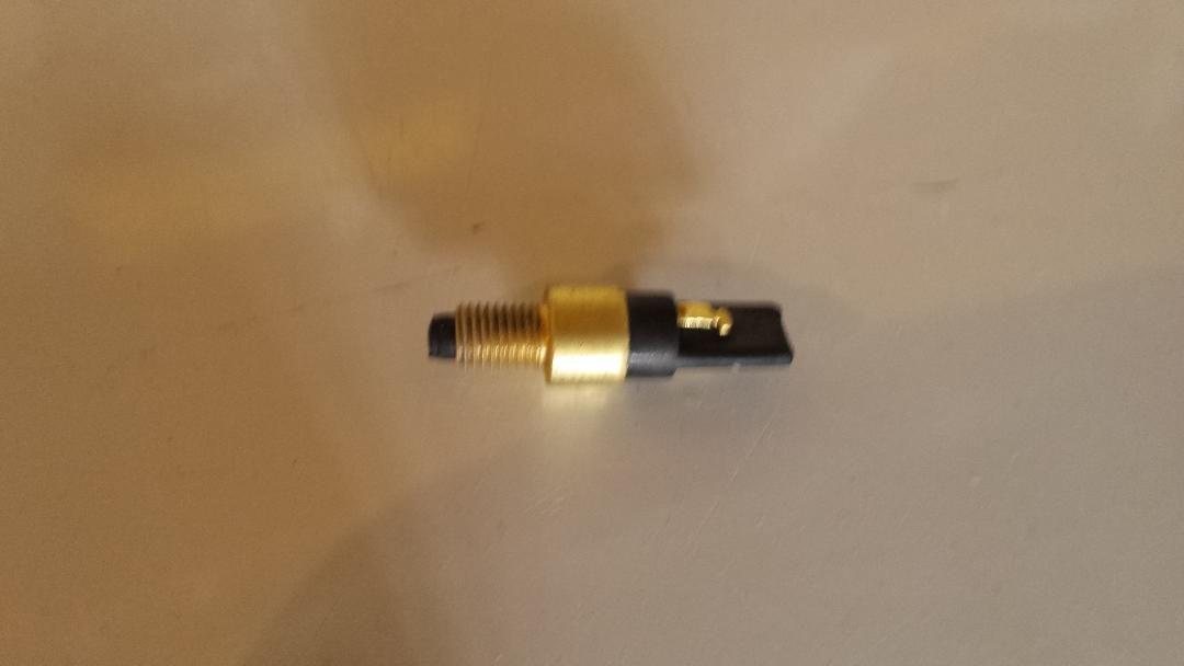

This is the 3rd time (in 3 years) I've had to replace switches and buttons. This time the old front brake switch didn't want to come out. I ended up removing it in pieces. Couldn't get the new switch in until i put a heat lamp on the housing for several hours while the switch itself was in the freezer.
If i have to replace any of these again, I'm thinking of retrofitting hand controls from 1990 or newer model year. Anyone done this before?
